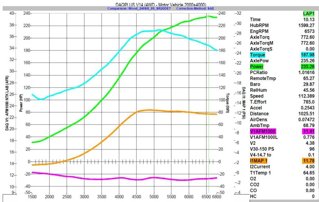

Dyno Tune via NISTune:
Chris spent a LOT of time on my car mainly because there was quite a few things wrong. My IACV was stuck, TPS was bad. We turned up the boost to 17 lbs, but found out soon enough that my fuel pump/fuel system wasn't up to par. It started losing pressure in the top end, even with a different adjustable FPR. With it running a tad lean in the top end it still produced 268 hp.
OVERALL I was very happy with the tuning, my car feels MUCH more responsive with no flat spots, and I got some bad ass MPG's on the way back from his shop. Used 1/4 tank of gas and drove from his shop to Bakersfield. Just wish I would've fixed the fuel problems before I got there. Will definitely be going back once all of my kinks are worked out, and I have some internal work done.
dyno sheet shows 235. where did you get 268 from?
Separate dyno sheet running 17 lbs. This dyno was at 12 lbs.
