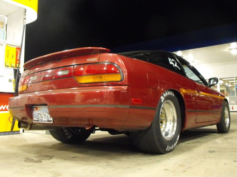

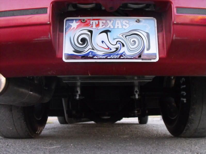

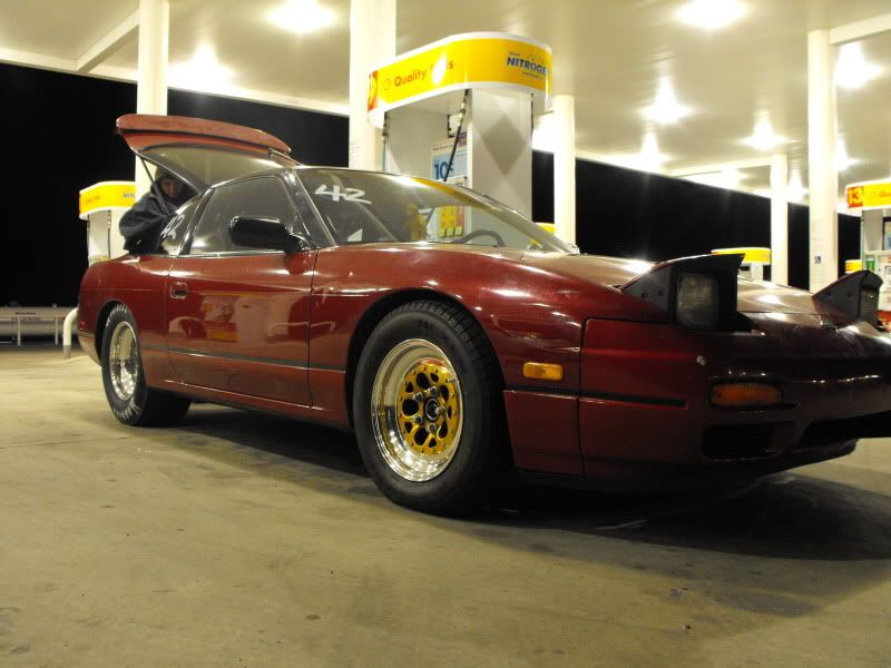

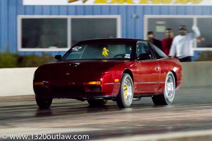

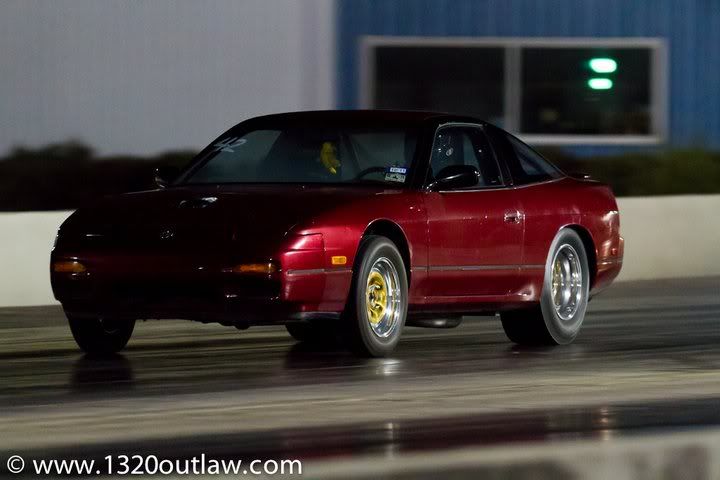

Back Halfed LS1 S13
This is a really good friend of mines 91 s13 back halfed with a 4 link in the rear, caged, motor setup is a stock bottom end ls1, stock heads with a texas speed v3 cam, harland sharp roller rockers, fast 92mm intake and throttle body, headers with a full 3in exhaust its also on a base map mail order tune from texas speed the car has never been scaled or suspension proffesionally adjusted.The car is only launching around 2200rpm off the foot brake the transbrake is on the way My friend spent a couple of years tryin to build this car and the outcome is coming along great still have alot of room to play with. We live in corpus christi tx and the closes track to us is in san antonio he drove this car to the track and drove it home with no problems other than a small oil leak on the oil pan nothin major though the car weighs out with him in it at 2685lbs. First pass was an all motor pass with a 10.94 60ft 1.5, by the end of the night we decided to put a 100 shot in it and see what its got it was around 45 degrees outside thats why the video is shakin lol but we only got one pass with nitrous hittin it in 2nd gear and ran a 10.32 1.4 60ft we see 9s on this setup for sure!!
http://www.youtube.com/watch?v=cE2XcXIZe4w
nismos nitrous pass
http://www.youtube.com/watch?v=_lv1pwH1nOU
nismos motor pass
i dont have any engine bay pics my other computer got a virus and as soon as its done gettin worked on i will post them thanks!!!

cool car, i don't like the back halfed idea but i can see why you did it, cause its been proven to work. What rear end is in it? Ford 9"?
