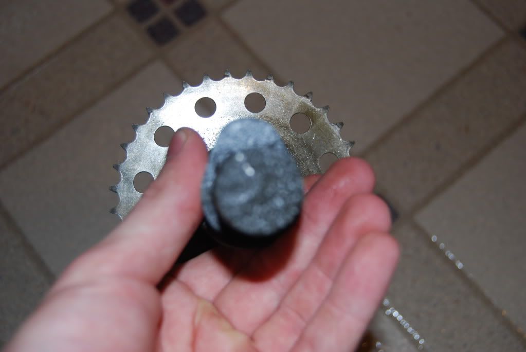

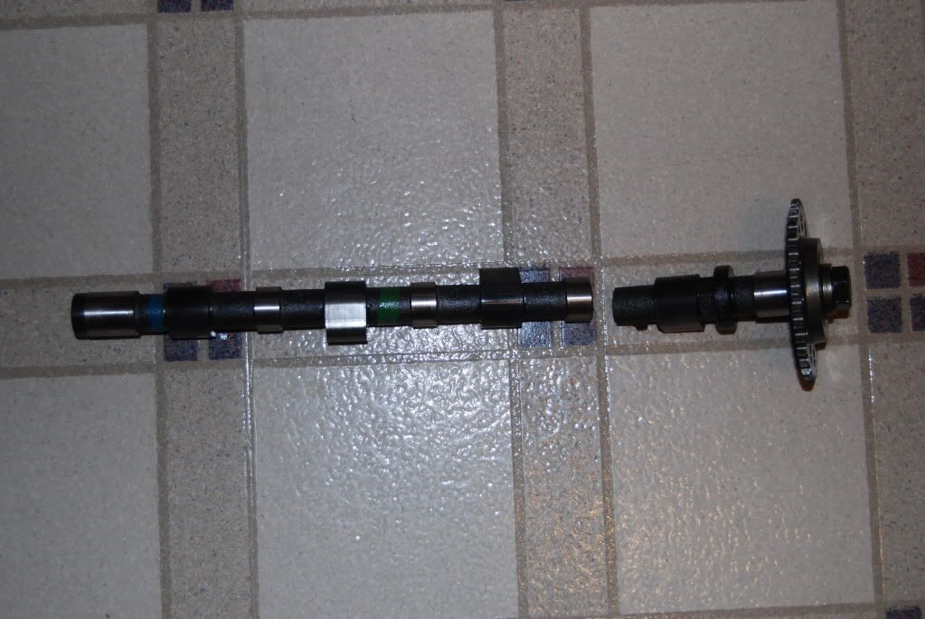

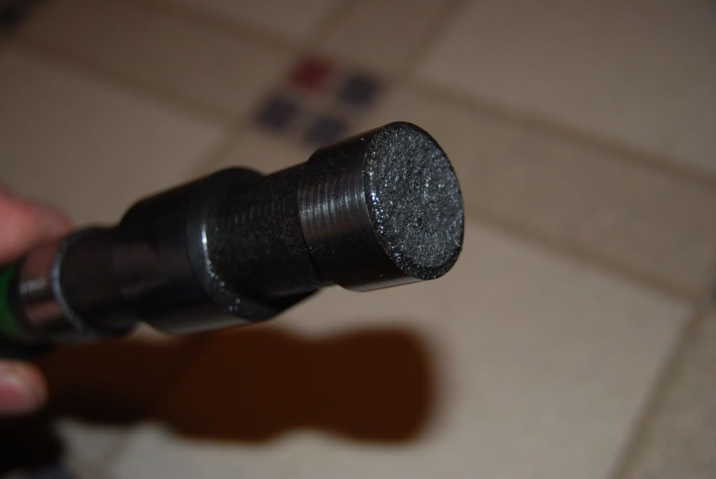

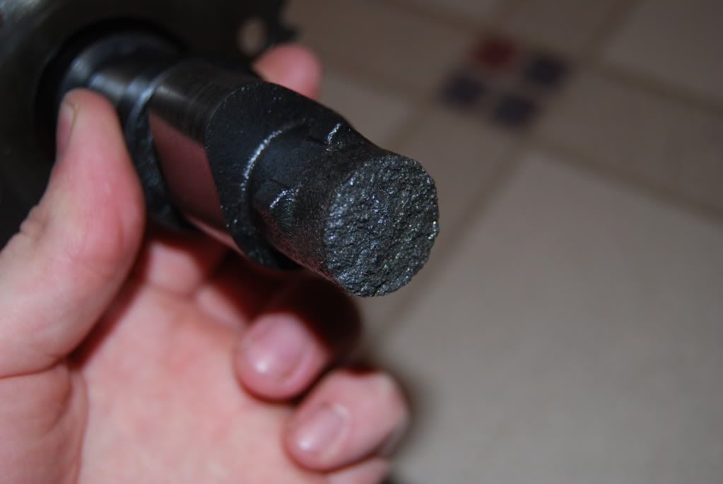

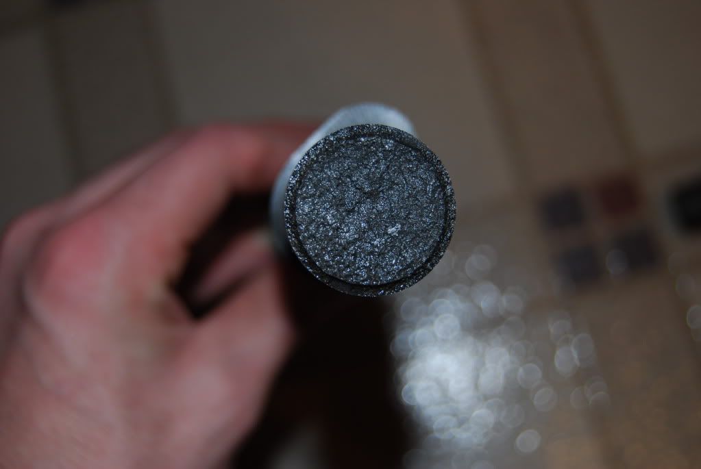

Fast forward to today, I get to look at it and I am stumped. I pull the valve cover to find this....
Intake cam
WTF?
Little info
- I always follow a fsm RELIGIOUSLY
- I have installed cams 4 times and never had a hitch
- mechanical timing was PERFECT, I checked it 3 separate times
before starting the car the first time ( I hand spun the crank ten bajillion times)
I pulled the motor tonight and am pulling the head off tomorrow to see the damage (will update with pictures), and plan on contacting Crower on monday.
