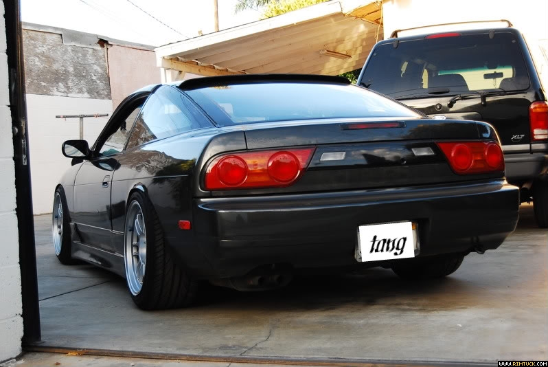

Can you comment on the lowering capabilities of the EVX's versus Megans. Or the amount of backspace available from the EXV N1's?
Jimmytango00 was able to get this low & fit 17x10+18 up front with EXV Pro's with no spacers under stock fender... Can I fit that same size with the EXV N1's?
RIMTUCK.com - Setup

If the Apex'i ones has the same body/outter design as the MRs, I doubt you'd fit 17x10 +18 up front if its slammed. I had MRs and I had to slap 8mm spacers to clear the front strut, while slammed to the ground on 17x10 +12. The inner lip of the rim was basically touching the spring. If you raise the car up where the spring and collar are above the rim, then you might clear.
Here's the thing though: Unless that guy I posted from Rimtuck lied about using spacers up front, its already been done. i know he's on Zilvia too, but he's never responded to my PM's.
His setup on Rimtuck says he's using Apexi N1 Pro's. Apexi doesn't currently sell a coilover with that name, so I figure it must be a discontinued model. I just wanna know what are the differences between clearance & lowering capabilities of the N1 Type Pro's versus the EVX N1's. I guess I'll just have to find someone at Apexi to ask at some point...
And as the the Megan's not clearing 18x10+18 without spacers, I thought thats what their 25mm extended brackets were for...

N1 Pro was an older series of coilovers. Not related to the EXV's. The N1 Pros were $2000+
