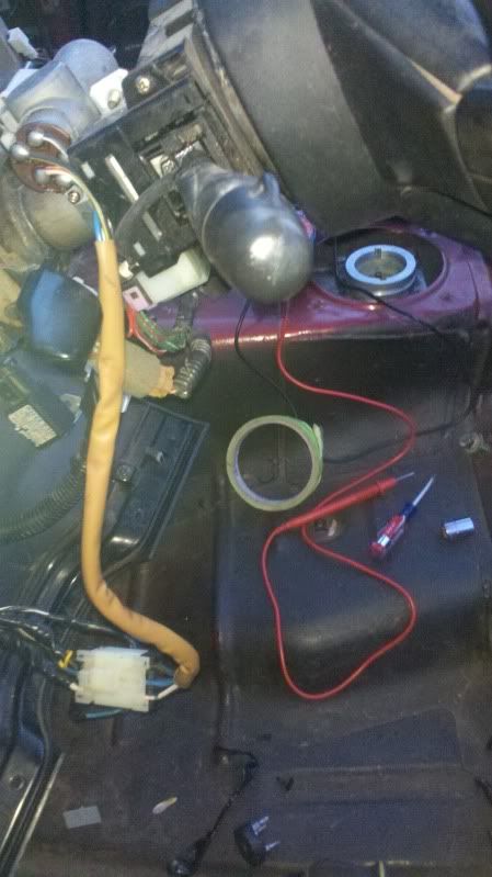

Aiiiiiight so I've been attempting to diagnose my no crank issue [ I just want to get the starter going so I can do a compression test on the sr20 ] but I havent been able to get the starter to kick over.
So here's the background info:
Wiring relocation, brought the chassis harness from the engine bay into the interior. Extended plugs needed for lower engine harness and deleted ac plugs, blinkers [oops] and fogs. (READ: cut wires at plug, cut wires at fuse box and covered the tips.)
Battery relocation to the trunk. Car does have power, I can turn on the lights.
Starter has power (obviously), but doesnt crank on full key turn. Signal wire not getting power.
All the wiring from the ignition switch is intact. The car was auto and yes the plug is looped.
So this is where we're at... plug going to ignition switch is getting 12v [Volts AC] ((I think it said like 20v on Volts DC.... wtf?)
plug coming off the ignition switch is displaying no volts on key on accessory or full turn.... So what the fuck would cause this?

Let me make sure I'm doing this right. I attached pos and neg to my battery, put the neg on the chassis and tried the positive on both screws on the starter thats chillin on a seat right next to the car. Not positive if that one is good or not, but I just wanted to double check if I was doing it right or not.

On the left hand side of the ignition switch, place the positive node of your multi meter on the white/red wire (right where it's soldered to the switch) and ground the negative multimeter node on bare metal somewhere on the steering column. It should have something like 12.5v with the car "off", "acc.", "on" and I think even the "start" positions. It should have constant power though (on or off). The black/white wire should be 12.5v in the "on" position, but nothing in the "off" position.

I did what Pandapants said also, I didnt get a reading when the multi was set to VDC.
