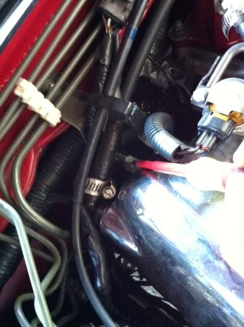

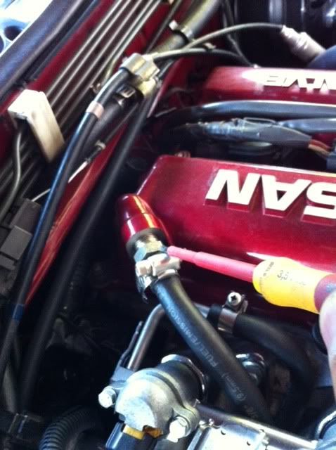

I have ISIS intake manifold. Question:
Does this port behind my intake manifold:
hook up to this port on my valve cover?:
Could this be the reason there is oil in my intake manifold? Doesn't seem like there is a lot. The only reason i say that, is because i unscrewed one of the vacuum plugs underneath the manifold and the bolt had a layer of oil. Thanks

if you actually look at the pic you can see that that hose does not go to that port you can see that it goes along the fire wall.
Its common for oil to build up in the bottom of the IM i think a solution is to install a mini Oil catch can for the PCV valve system

Behind my intake manifold, there are two ports. One port is connected to the brake booster and one port is connected to my valve cover. When i changed out my intake manifold, i connected the lines like the stock manifold. So that port on my valve cover is supposed to connect to the port behind my intake manifold? I've seen some people put a mini filter there. Is that the proper thing to do?
