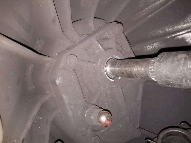

I know your problem. You must pull the tranny off cause the shaft where the release bearing slides is broken. Happened to me

wait youre suggesting the input shaft in the tranny is busted or the clutch fork is busted?
ill put that one on the back burner for now seeing as ive never busted a clutch fork in any of my other cars and the one that is in there showed no signs of excess wear and tear when i changed the clutch.
No, its a 'hollow' tube per say that goes over your input shaft. Its what holds the release bearing in place. most definitely going to be your problem. same symptoms when mine broke
Actual photos of mine broken:
