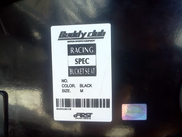

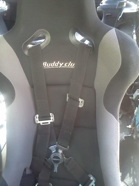

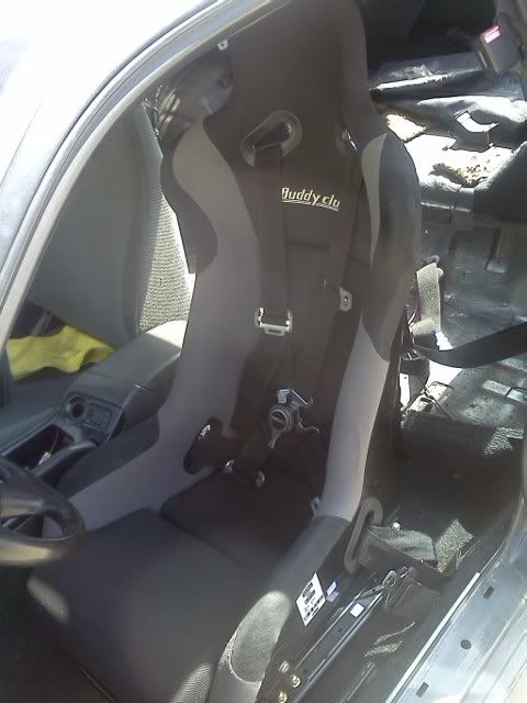

WTT Buddy Club Bucket Seat for Mechanic Work!! ASAP!!
I posted it on my previous threads but i wanted to start one for only the seat.
I want to Trade my Buddy Club Spec Bucket Seat For someone who can fix my car!
I hate to sell/trade my seat but i CARE MORE ABOUT MY CAR!!
I DO NOT HAVE SEAT RAIL OR NRG HARNESS
