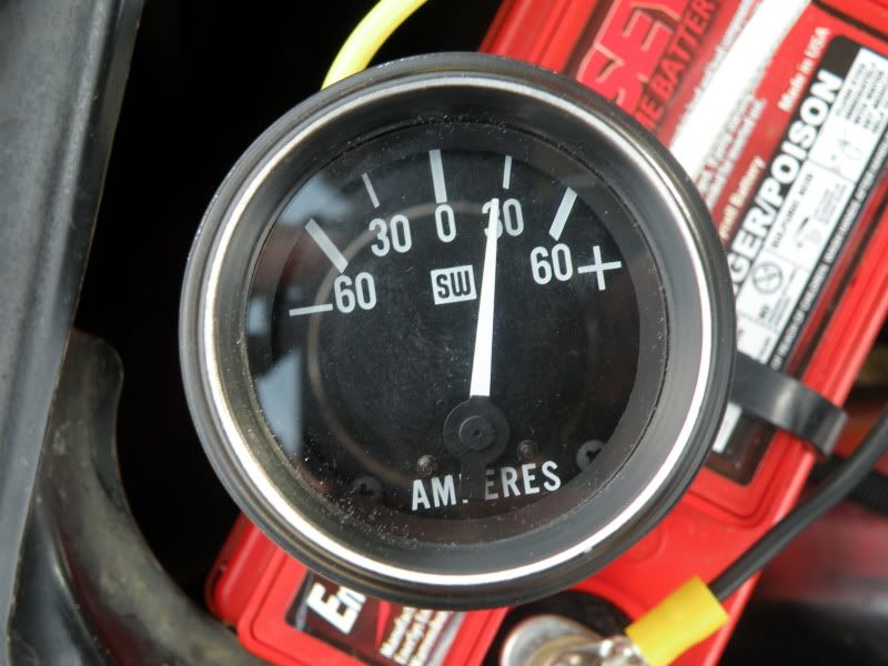

gotcha, Bur yeah like I said, they pull too much. Version D is rated at 25Amps and FAL's pull like 28Amps.
Its not much over it so I will slowly kill it depending on how long the Fans Cycle
a buddy of mine that had the same issue.
