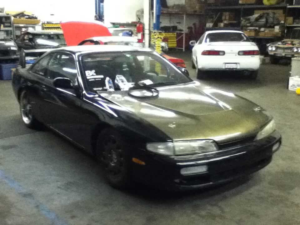

here are some pics, I'll keep adding em as I go down to G-dimension and take more pics...I know that's generally what people actually care to see.
the car before I put it in the shop this time around

Since a large portion of the pictures are at G-Dimension, and most all of them will be from now on I figured I might as well explain a few of the other cars being tuned along side mine. Most if not all these swaps have been done at G-dimension itself. The Red S14 is an RB25 swap and is being outfitted with a GTX3076 turbo setup. There is a black S14 behind mine which is getting a similar build to mine but scaled back (without the VVL conversion) and they will be running a GTX3576. The miata behind my car is currently one of the fastest miata in its class (some form of road racing...dont know exactly which class, probably unlimited RWD) and is running a GTX28...76? and a very sexy V-mount setup (along with tons of other mods). The Datsun off in the corner got a stock redtop SR20det with a top mount turbo (I think a GT28) and a few other small goodies. Not in the picture but its around the shop, a very crazy looking purple wide-body s14 kouki got an RB26DETT swapped in. Also not pictured is a black LanEvo XI, FULLY, and I mean FULLY built...the guy who owns it travels a ton so its kinda at a stand-still...plus it needs an AWD dyno but its a beast. And lastly, way in the back in Silver is a 280Z also running an RB26DET (converted to single turbo) running a GTX3582R, the same that will be in my build. My build isnt really starting till the 2 Datsuns are finished, which should be some time next week (its also when the motor comes back from the machine shop)...but the other cars will be around.
