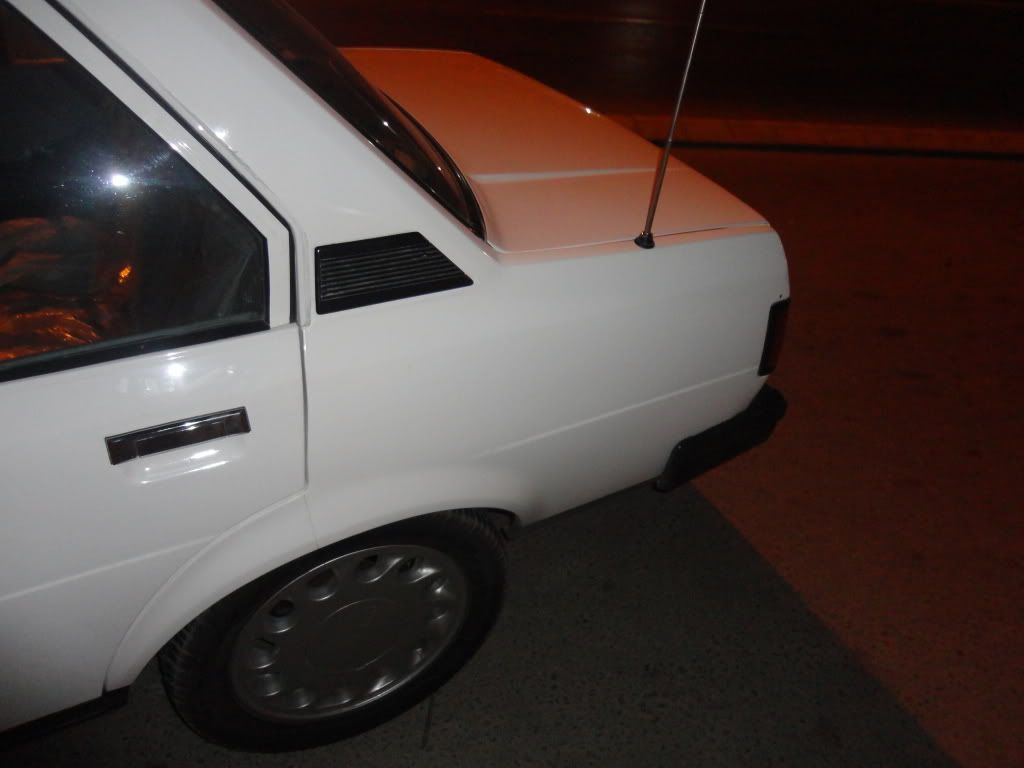

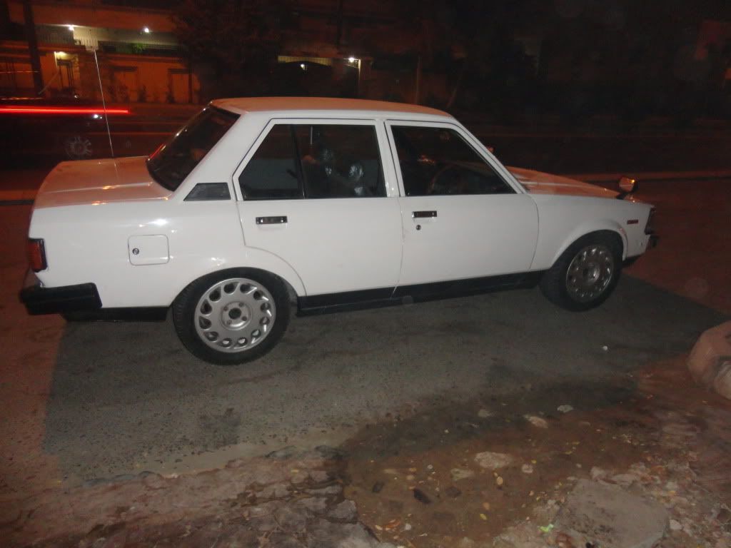

its a corolla not s13 in next two months m going aem with map for the time being i wanna play with stockies
here you go
ke70 corolla sr20det redtop t28 s15 7 psi stock motor
yes I am aware of that do you have pictures ?
yea have posted pics for you i know its pretty plain car like aw11 mr2 two tone
