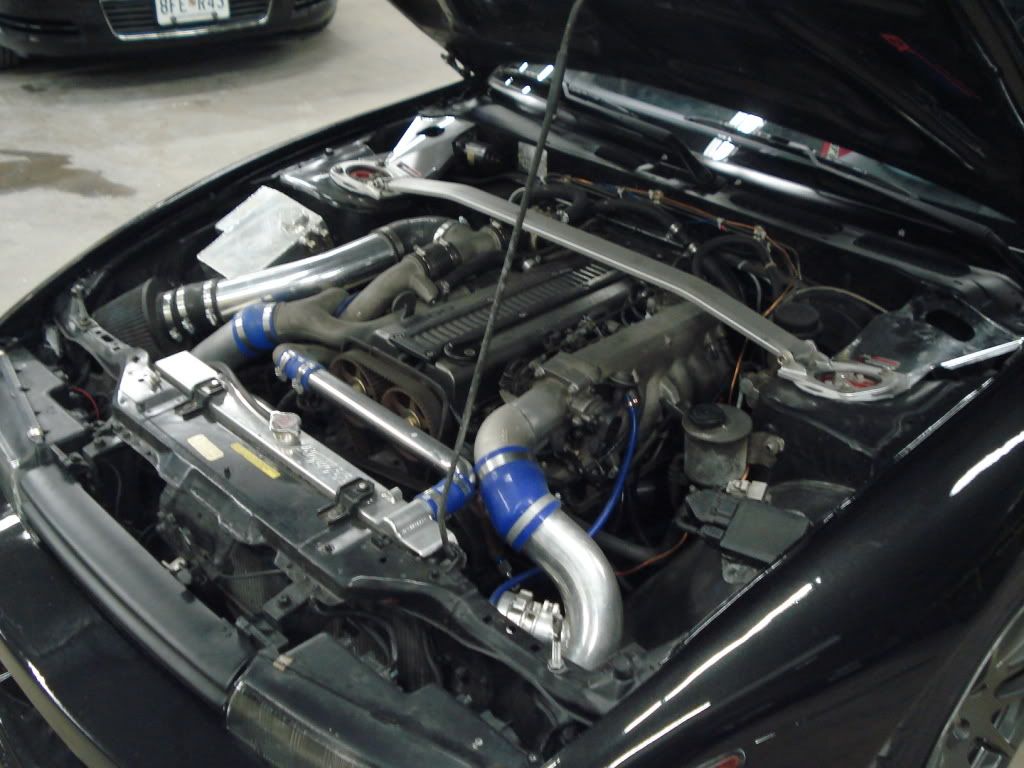

theres one thing i would like to know. whats everyone useing for the uper rad hose that runs across the top of the pulls in front of the cam gears to the other side.
see he has the crome piping running from the water neck to the top of the rad? what is he useing is that just intercoller piping with some 90`s on the ends?

Looks like he used 1 or 1 1/2 inch pipe with just one 90 degree bend with some silicone hose secured with regular clamps....you cud robably find something like it on ebay

If you use a KA radiator you can use an IS300 upper hose.
