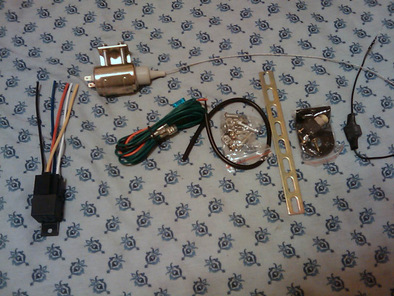

Items you will need:
- DEI 522t Trunk Release Kit
- Plenty of 16 AWG wire
- Soldering iron / solder
- Electrical tape
- Phillips screwdriver
- Wire stripper/cutter
- Bosch relay
Here is everything laid out...
Now this isn't necessarily a hard install, but it will take a few hours if you want to do it right and hide the wires as best as possible.

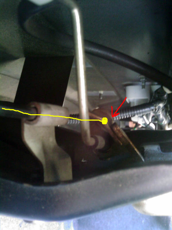

The first thing I needed to do was to inspect the trunk latch mechanism.

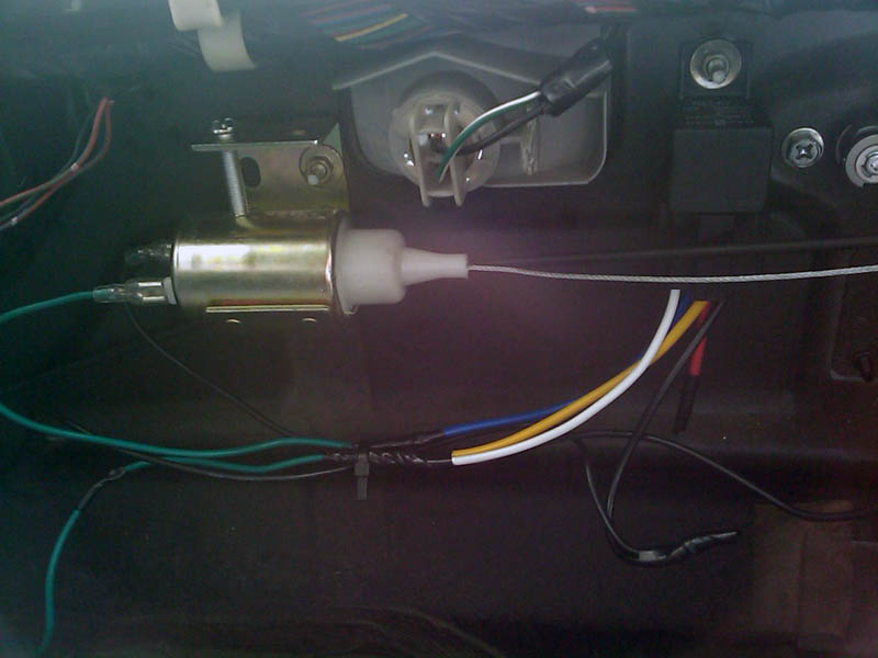

The manual wire you can see I've highlighted yellow, you will want the solenoid to mount from this direction (right side). Red arrow indicates where your new wire from the solenoid will be going.

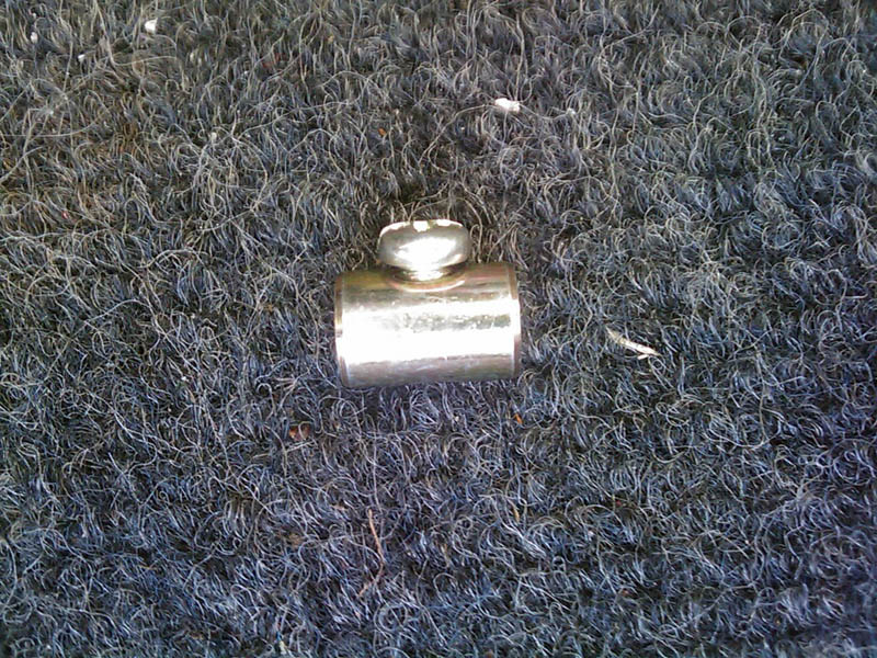

This is the little piece you will feed the wire into and then screw down to lock into place. It's important to remove all the slack so that the solenoid can get a good pull on the wire when you go to activate it.
Solenoid mounted. I used one of the 8mm tail light stud/nut combo to mount it. It was really nice of Nissan to use 20 studs to mount the tail light assembly to the chassis LOL. At this point you can hook up a ground wire from the chassis to one of the prongs on the solenoid (it doesn't matter which one).
Here is the little clamping piece fed through the wire and then tightened down. You will want to make sure your solenoid is mounted firmly before finalizing this step.

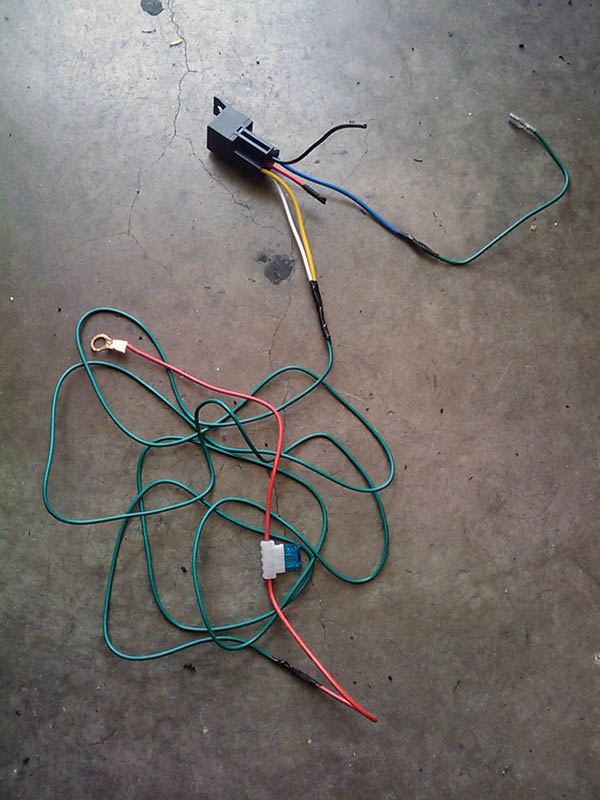

Relay setup.
Here is a diagram...

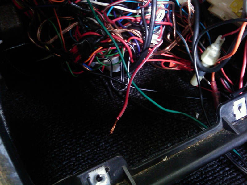

Now for Viper alarm systems, I had to locate the red w/ white stripe wire in the main harness. Thank god it was right out in front so I didn't have to fishing for it in my cluster bomb of alarm wiring... LOL
**Note: You can use the supplied button switch as the ground signal instead if you don't have an alarm system. But the whole point of this install is to utilize your cars alarm system so the remote will pop your trunk.**

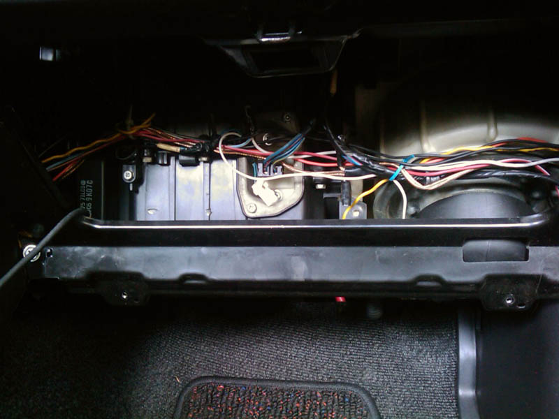

So pretty much the only annoying part of the hole process if feeding / hiding the signal wire from the front of the car all the way to the back. The same idea would apply for the 12V source wire too but since I relocated my battery to the back, this was a lot easier.
This is my common area for hiding wires, LOL.

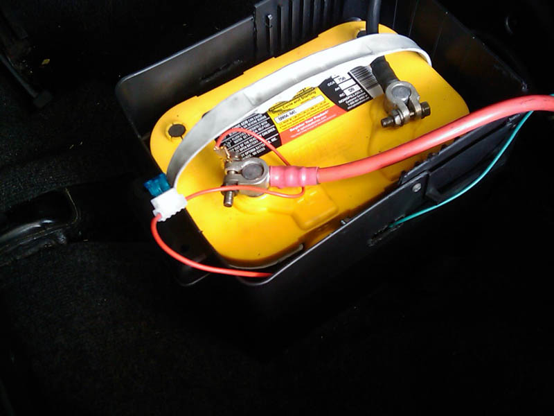

12V source wire hooked up to the battery terminal and then fed out of the box and underneath the interior. Don't forget about installing the 15A fuse (unless you like fires).

Finalized product. Black wire on the solenoid is to chassis ground, and the green wire is from the [30] of the relay which supplies 12V once the ground signal from the Viper alarm system is activated... As you can see I used another tail light nut to mount the relay to the chassis, props again to Nissan.
