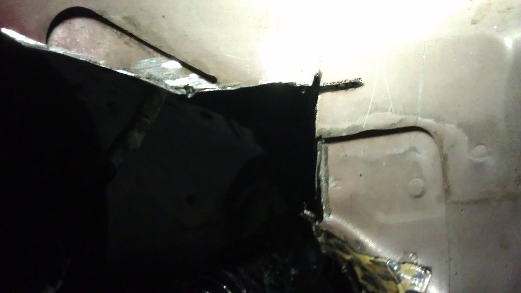

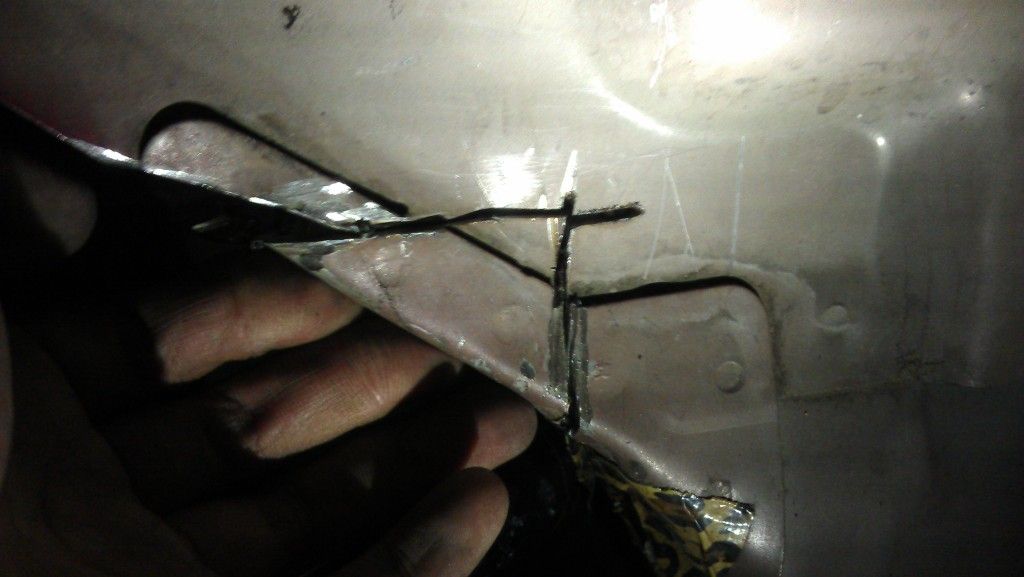

mark where you want to cut(pic is piece already cut but put back into place for reference)
IMO it was the perfect size cut for the harness to fit into.

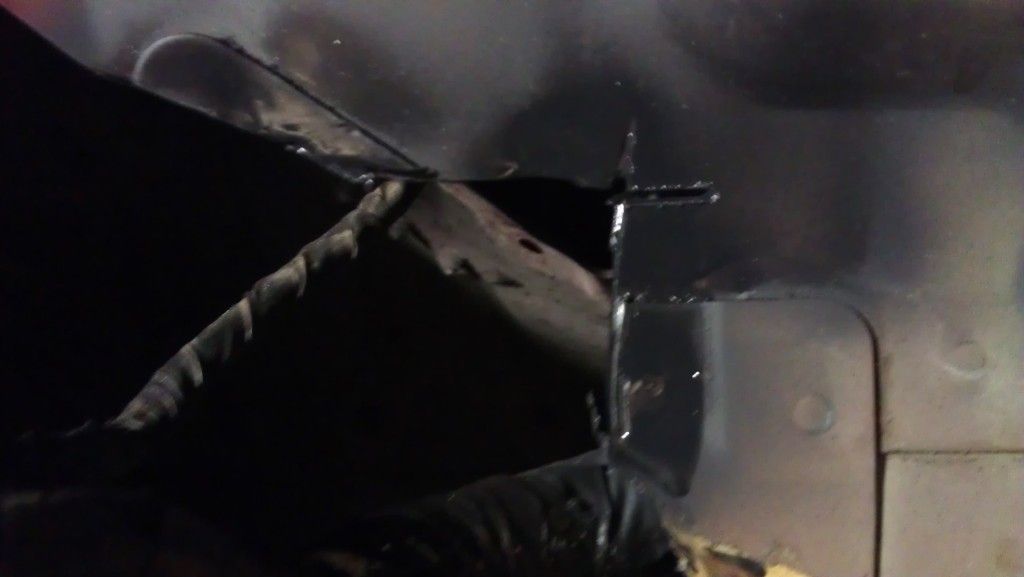

Chunk cut out, used the hammer to hit the chunk out because the side grinder would not reach
Primer the fresh cut to prevent rust

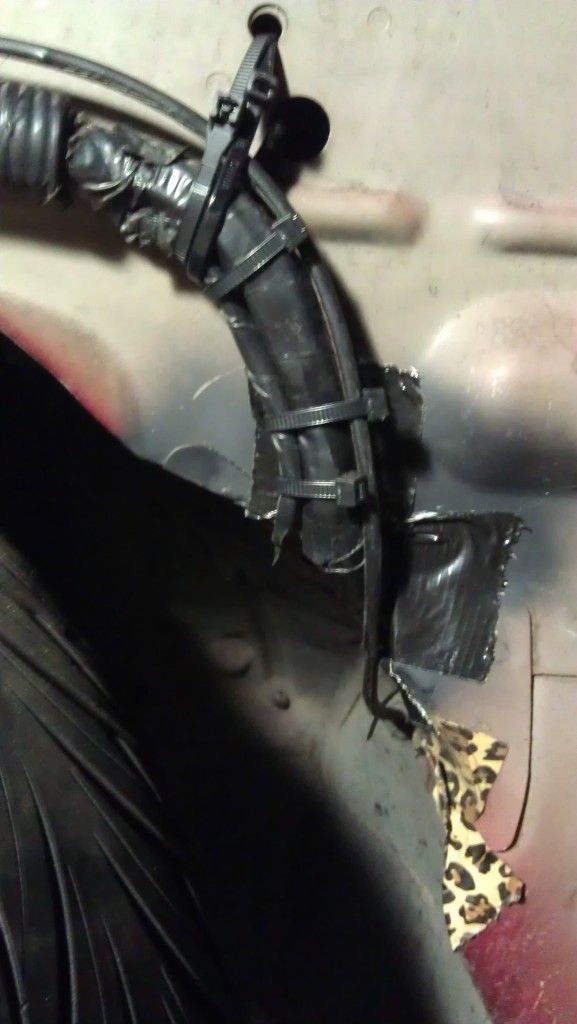

Finished product, i threw some duct tape over the primer after it dried so the edges of the cut wont cut into the harness.ziptie your harness using the holes provided by nissan ^^
