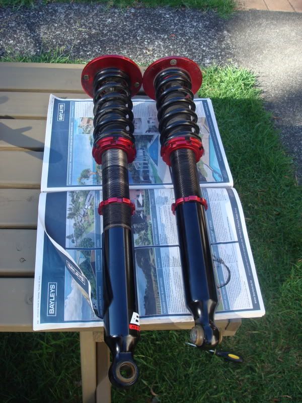

Hello,
Not sure if this pertains to any other coilovers out there, but my Megans have a silly step on the bottom of the shock tube, which prevents the shock from threading in all the way to the bottom.
I would really like to have the step milled out, but I am not sure where to have this done, or if it is feasible without damaging the threaded part at the top.
Thanks to Mr. Ian Perry I found this picture which shows exactly what I am referring to.

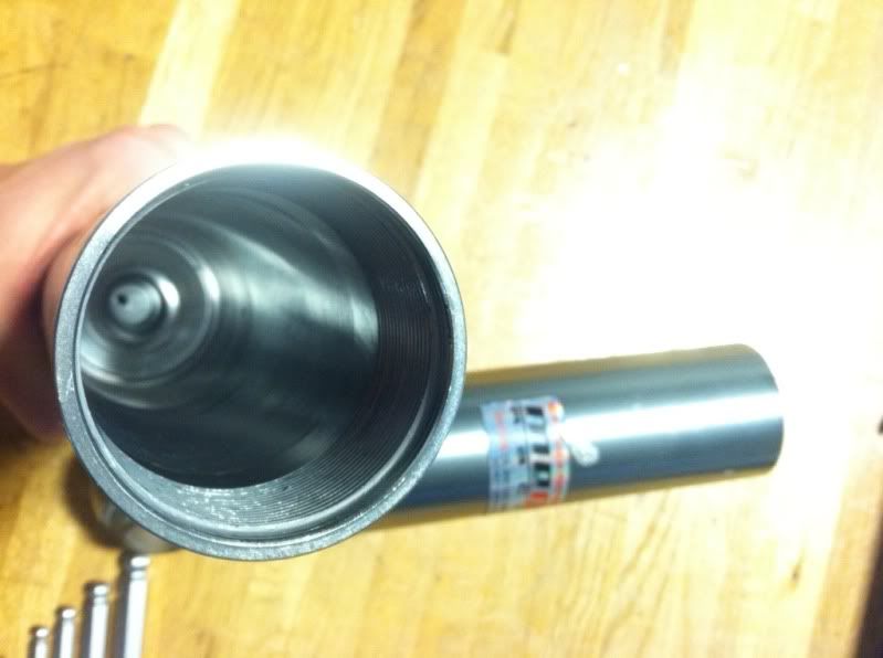

Have your measured how far down the stopper goes? I am curious because I have the same ones. Isn't the stopper right at where the tube tapers thus making it impossible to lower the inner tube anymore anyways?
In the picture on the right the shocks are as far as they go in, so the stopper starts at about where the bottom of the sticker is.

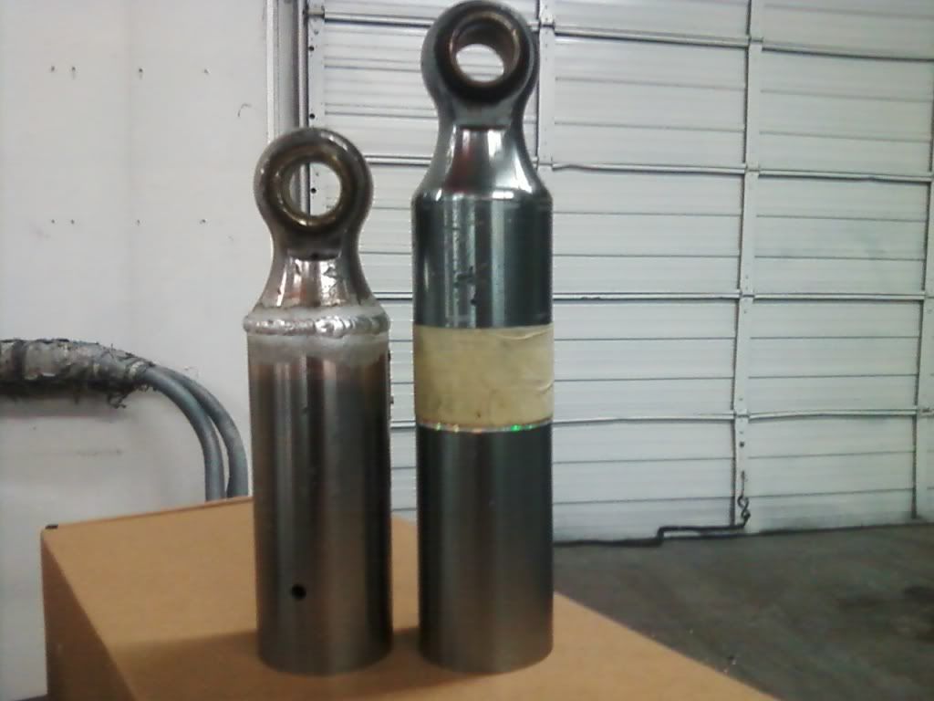

Actually considered that, or just having the stepped part cut out and making the tubes shorter, but I assumed that would be even more complicated. However, I am no expert on welding and machining and such, so I cannot tell what would be easiest.
I am sending the tubes off to Mr. PoorMans180SX whose friend should be able to mill them out.
He already helped with shaving my seat perches to fit my new springs and he did a wonderful job. (I did not want to use the larger diameter springs because I hate when springs do not fit snugly or overhang.)

^ yup that will be the easiest way. Thats what i had to do for some 240z coilovers. U dont need to take it to a machine shop i got a perfect cut with a 2in pipe cutter for pluming

i can cut and reweld them for 80

You should be nice and safe with cut/reweld or cut/rethread. You'd need to find a machinist with the tooling available to cut threads to fit your shock tho.

it came out looking good, i did the cut and weld and it also worked great.....no problem even dirt dropping lol
it gave us an extra inch without messing with preload.

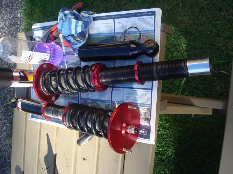

For reference, you can also bang the shock inserts into a lathe, and take the lower 2" of thread off.
Full low without machining on the left. Full low after on the right.
P.S. Not my pics, stole them from a local forum to illustrate my point.
