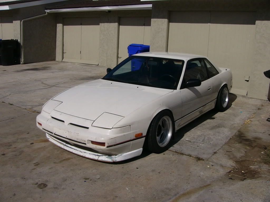

Just picked up eagle alloy 028 rims 4x114.3 15x8 with -30 offset and i cant find the lug nuts that fit the oval uni-lug holes. I know I have to get mag style lug nuts but I don't know where to get some that fit. I've gone down to my local tire shops and the lugs they give me don't fit in the outer part of the ovaled hole.

Thats not the way they come from the wheel mfg , somebody has ovaled the lug holes out ,Just use a mag seat lug w/ washer, but your going to have to get a set of Hub centric rings since the wheel is not lug centric anymore . Call Excaliber wheel acc in Ontario they will have the lugs

Nowhere sells these rims. And they do come with oval holes. I cant find the right mag lug nut. The diameter of the shanks is too big for the hole

Those would need the hubcentric rings and flat lugnuts not tapered type. Try these, Summit Racing Lug Nuts 12mm x 1.25 .685" Shank Dia Zinc Set of 24 on eBay!

Because those rims are like 15 to 20 years old and the only way lug holes get ovaled out like that, is someone redrilling them wrong. Trust me I manufactured wheels for years an years

mag shanks is the lugs u need. it looks like someone used the wrong lugs and the wheels was somehow moving when rolling and it made a oval shape? go to pepboys they sell some shanks that are skinny , maybe those will fit.

they are like that. i had a set of them and they are ovaled as well.
to the op. you can go to any wheel shop that sells insert type lug nuts. any tapered bottom wont work with this. trust me.

12x1.25 Mag style lug nuts with a shank diameter of .68" (17mm), a shank length of .472" (12mm) at the least, hub centric ring with the inside diameter of 2.598" (66mm) and the outside diameter of 3.110" (79mm). Thanks for everybodys help!

Agreed.... I currently have a 15x8 -30 set aswell and the holes are ovaled aswell. Louds manufacturing of wheels obviously came pong after these wheels production because there are many us made wheels from that time period w the same thing. For anyone intetested my set is for sale haha
