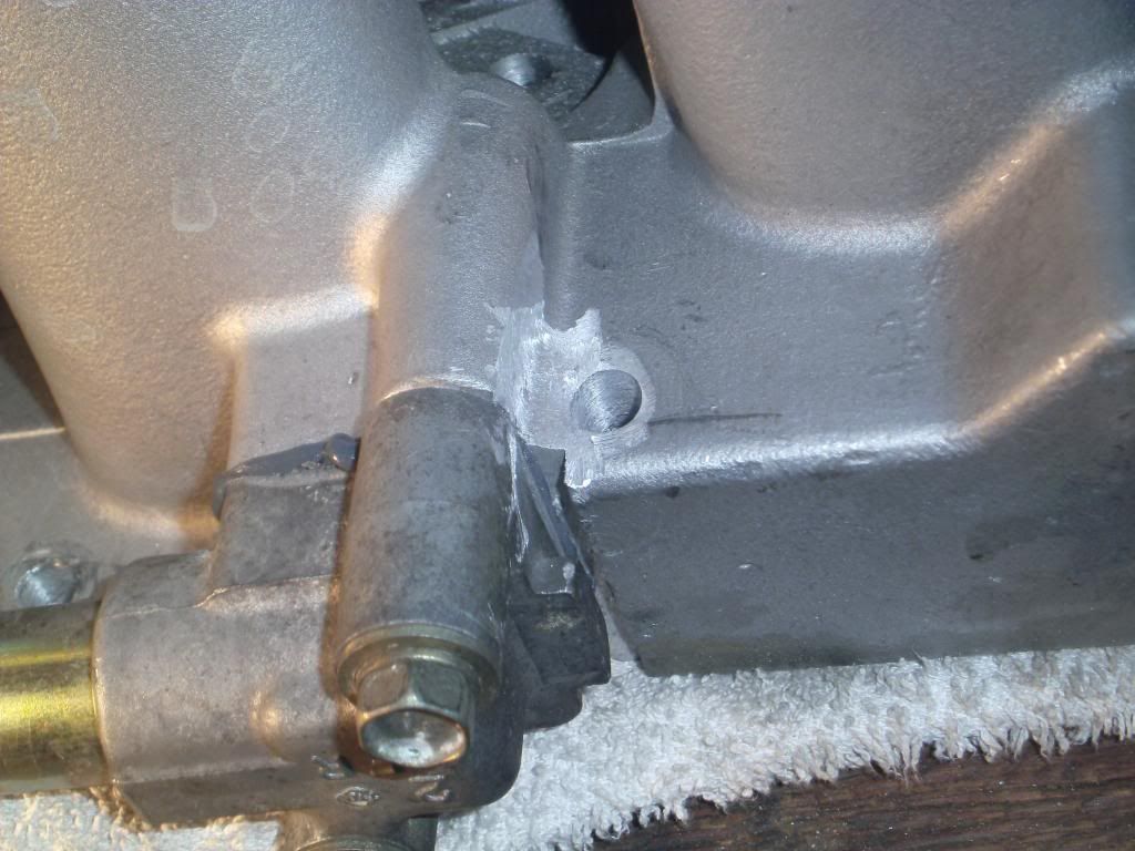

2nd thing is file the flang down for any inperfections. don't take off too much as a little bit will do it. you need to hold the file and use mostly your palm in a forward and backward motion to smooth the flange.
This image has been resized. Click this bar to view the full image. Report this image
i learned this the hard way after i installed the mani before doing this or my next preperation and water leaked out the bottom of the mani.

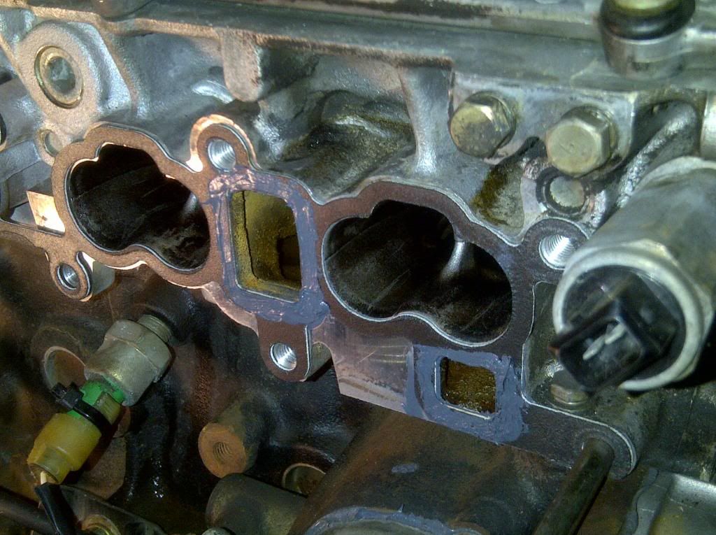

like i said, before ina rush to slap this on i got a leak when the car ran, so now iam going to do this the "right way"

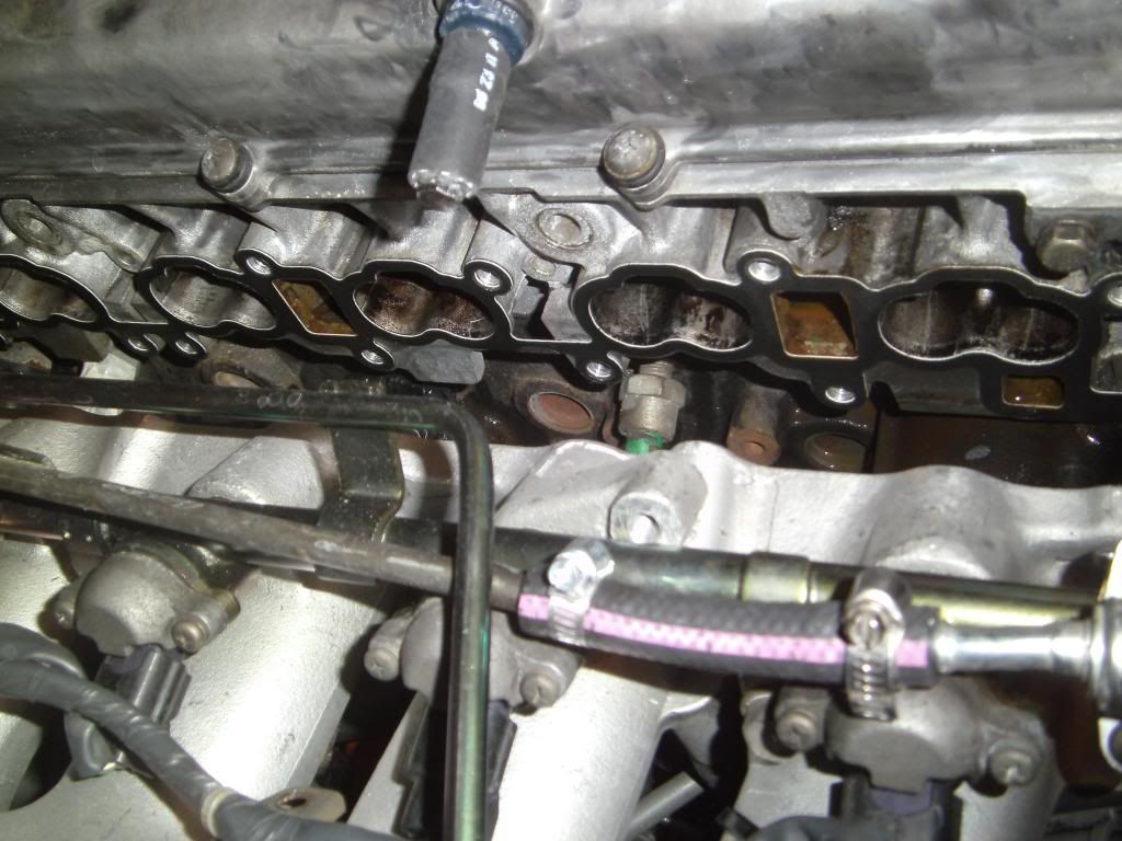

so after i smooth out the intake mani flange. i then put some nissan rtv around the coolant galleys on both sides of the intake gasket, just for piece of mind.
1st remove the mani. i installed this when it was outside of the car. it appears it's a cluster to get off. but with ratchet extensions it's really not that bad.
these are the coolant galleys

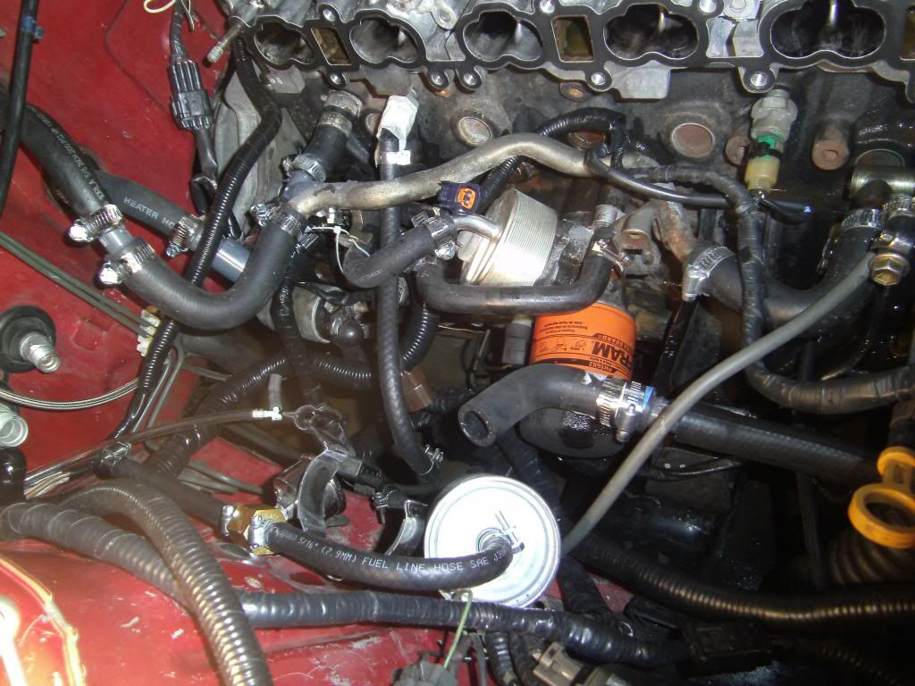

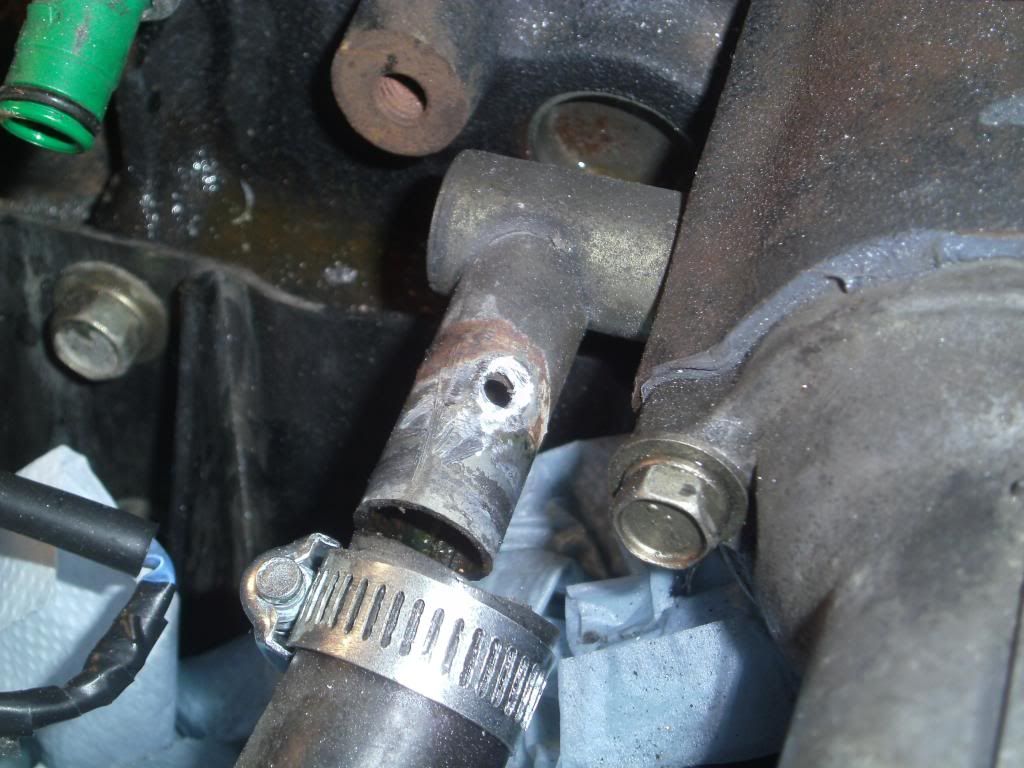

heres what the coolant/air lines looks like now with the ffim. it took me a small fortune of hoses to cut and make the right ones fit. get a bronze connector t as the plastic ones can't handle the coolant heat.
and while you are downthere, if you havent there is a water neck nipple you won't be needing anymore.
slide the hose over and violia!!

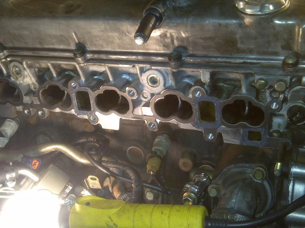

now time for gasket prep
i also put some on the other side so nothing will ever leak again.

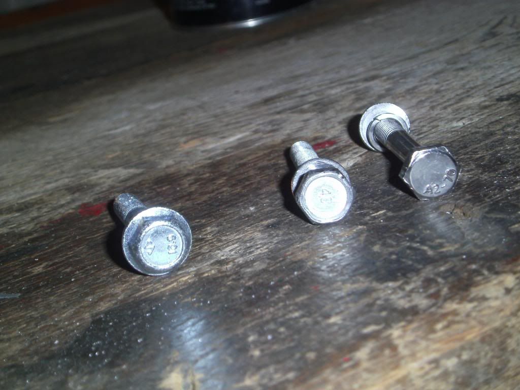

so next up and the main reason why people have problems with these are the ubber cheap bolts!! they aren't strong enough. and with the right tourqe they will break, and you will be butt-f***ed. so i took the bolts that came with the mani, went to local ace hardware, and hot harder bolts.

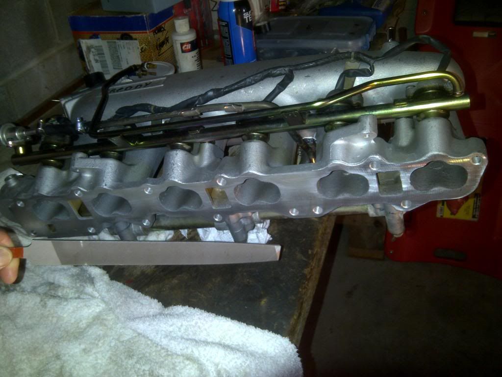

also while you have the manifold off smooth this part over with a die grinder. so you can get a socket clearance to slide over the bolt .
