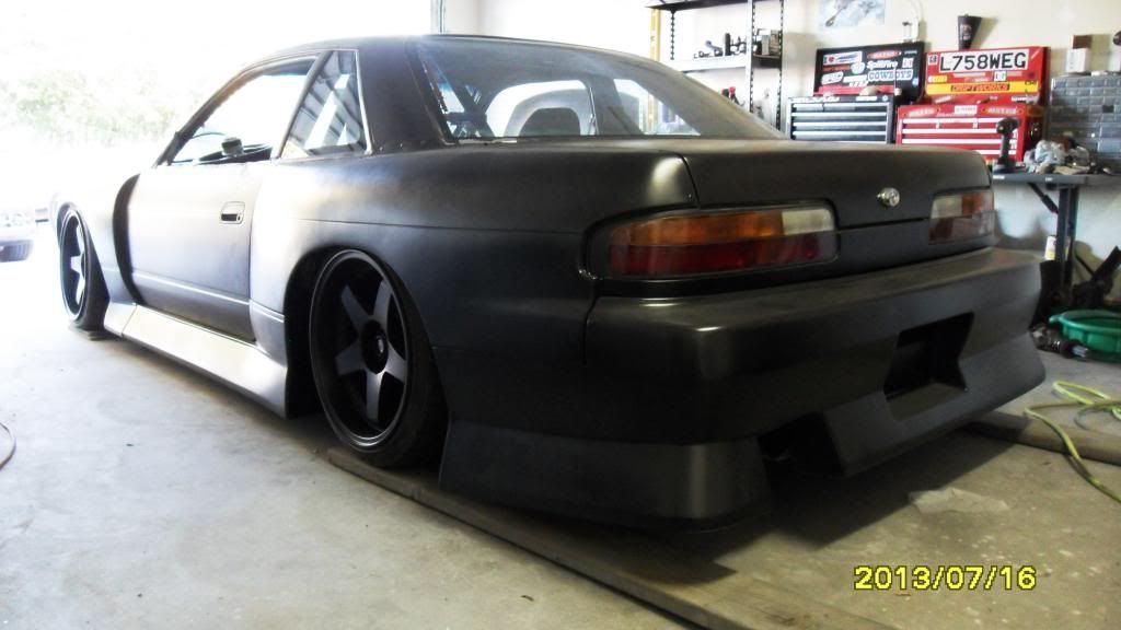

Hey guys I was just wondering is anyone running Driftworks hubs and PBM subframe risers?
I am having some trouble. I also have PBM coilovers and the rears set as tall as they can safely go are just way to low.. with the car on stands still the tire is already tucked into the fender well almost to the rim!! its ridiculous
Bn sport blister kit with 18x10's and 225/40 tires just if anybody wanted to know..
Any thoughts??

Post pics something dosent sound right

Post up some freakin pics

i am running zero camber in the rear.
i will post a pic this weekend
and i will look into the s14 shock option. i thought about this before but i was un sure if it would be to much longer..
thanks everybody for the good info

From my understanding of the rear drop knuckles the suspension pickups are raised while the wheel bearing mounting points remain the same causing a false drop and restoreing factory loke suspension geometry. This would not cause the car to sit any lower but it will effect the angles of your suspension arms

You have it backwards. The hub mounts/ spindles are pushed up in the knuckle. This drops your car however far the hub was raised, from it's current height. So Driftworks Drop the car 45mm front and rear.

Set at there max ride height lol....
