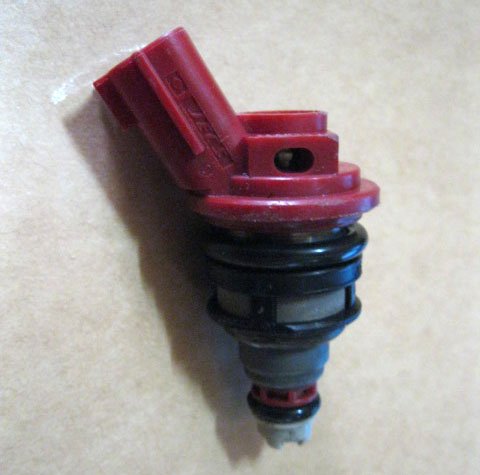

they hold the injector o-rings in place.. if the seal moves it will hydro lock & flood your engine with gas.. dont drive it

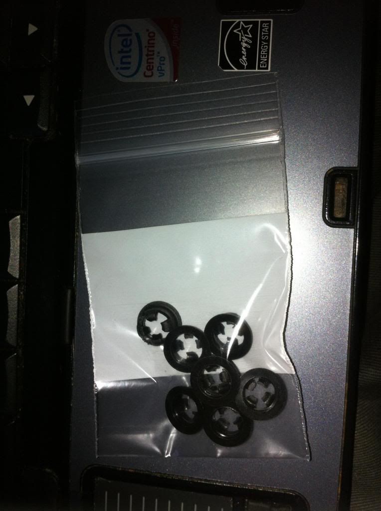

Buy like 6 or so because they break easy when installing them
Nissan JECS Pintle Cap
Hey, cool, I was just wondering where I could get a few of those. I've got one that I had to cut off a bad injector, and wrap around a good one....
But dude, they do NOT hold the o-rings on, they have something to do with swirl/atomization (and maybe keeping nasty egr stuff off the tip of the injector).
If your o-ring is that far down once the injector is installed, it's already been blown out of it's seat and into the manifold, and you're flooding.
Thanks that website is just what i needed. Those pintle caps says its for nissan infinity tho will it fit on my Kade?
you sure you know what a pintle cap is? looks like it holds the o ring in place to me? Google Image Result for http://demonwyld.com/temp/injector_compare2.jpg
if you know how to install them you shouldnt break any
You ever held an injector? You understand how an o-ring works?
It's compressed between the flange on the bottom hole in the fuel rail, and the seat above it on the injector.
If you had those things holding your o-rings in place, you'd be in trouble.
By chance, they hold the o-ring on so that it won't fall off if you're just holding the injector, but once it's installed, it has nothing to do with the o-ring or a good seal.
If you have to install an injector without one of them (obviously not ideal) just grease the lower o-ring heavily to hold it on. (you should always use lots of vaseline or dielectric grease on o-rings, or they can rip when you put them in).
why are you contradicting yourself?? they either hold the o ring in place or they dont. you really are a mechanicalmoron

i use a hot water trick to install these caps without breaking them. heat them for a few minutes so they soften up. fit on much easier.
They just so happen to hold the o-ring on if you're holding the injector in your hand. Once it's in the car, they do not.

You seem to be another one who has never held an injector. You have a picture, and I have a picture, illustrating the distance down to the pintle cap, which is not contacting the o-ring at all once the injector is installed (unless the ring blows out, in which case the cap will do nothing).
OP, if you take out the fuel rail to do the caps (and if you don't have leak issues) you don't need the o-rings, I guess. If you take the injectors out of the rail, you should really replace each o-ring, especially the lower ones, as they tend to tear when removed. If you take out the rail, it's on a manifold bolt or two, which sucks, and if you take out the injectors individually, it reeeeally sucks, and then sucks some more, it's simple but hard to get them to budge, especially with the position you have to be in to get at 3 and 4.

Originally Posted by zerodameaon View Post
Still don't care what you say, you have already proven you talk out of your ass so why would anyone read what you have to say and trust it.
My injectors have the pintle cap butt right up to the oring, it may not be the only thing holding it in place like I said.
And wtf are you talking about at the bottom there? It is pretty simple to get injectors out. Simple but hard? WTF are you talking about, you really like to contradict yourself.
Even if your o-ring was flush with the cap, the ring is compressed by the lower side of the rail and the ledge above it on the injector body. The cap simply has nothing to do with it seating, sealing, or with retaining it in place.
Is english your second language? It is more simple to remove the injectors individually, but it is (or can be) hard as hell to get them to pop out. These are not contradictory concepts. Simple does not mean easy. Juggling transmissions is a simple concept, but is not an easy feat.
my orings looked loose like that when the cap wasnt pushed on all the way. doesent look right at all.
i see they are dw injectors? nice

Heres what I got, it came in the mail today. I wanna do this tomorrow, anyone got step by step on how to install.
http://i1280.photobucket.com/albums/...ps35fce921.jpg

You also need o-rings.
Assuming you have the patience (and leather gloves) to pull the injectors, that should be MUCH easier. Take em out, refresh all the o-rings and caps, grease them (lots) with dielectric or vaseline or some other clean/clear petrolium grease/gel, and pop them in. You have to take out manifold bolts otherwise..... don't want to risk breaking that gasket, then you have a WHOLE mess of work on your hands.
IMO anyways.
