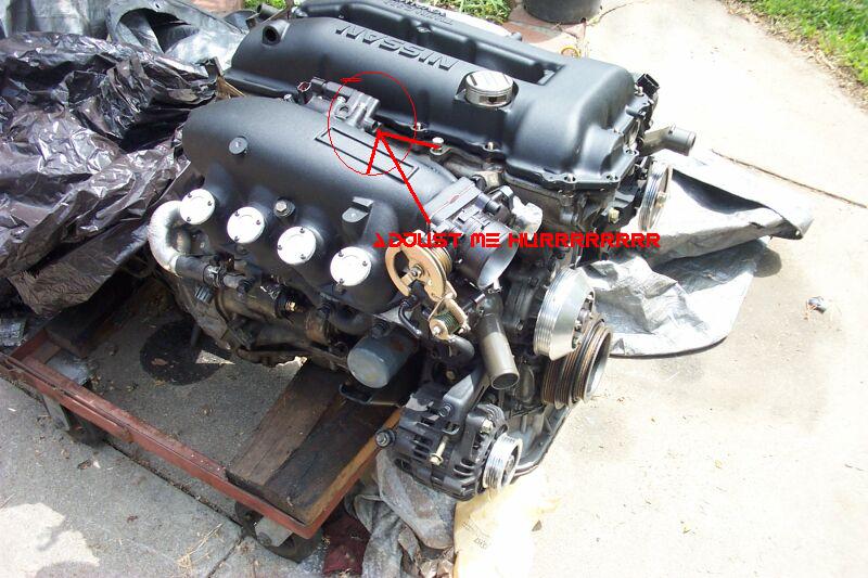

I would really reconsider that BOV, its one leaky bastard , would always stall out under heavy braking and idle just a tad off.
BTW, you have S14 SR, so here's a pic of where to adjsut the idle
cant miss it
play with it

LOL great pic Kid Z too funny. Ryan... all seems to point to your BOV. especially since its not aconstant thing. if your idle was ofdf it would be constant not bouncy like yousay
