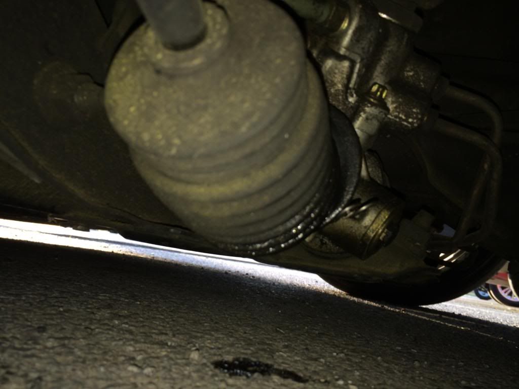

I have a leak pretty sure it's oil, I have no idea where it's coming from though. It's on the boot ( left front of the car)

Your power steering rack uses oil to operate, the boot is all wet with oil, it's safe to assume that your rack is blown.

While the leak is fresh, go stick your fingers in it, smell it, feel it, look at it, etc.
Check it against your power steering fluid, and check if your fluid is low. It's usually red, so if the leaked oil is red (or any color that your motor oil is not) that's a safe assumption.
If you're not positive, you can get UV dyed power steering fluid, and use a blacklight, to see if that's the problem.
Unfortunately, pretty much everything ends up leaking down off the rack, gravity's a bitch. Oil being there doesn't mean it came from there.
The sooner you get further under there, the more likely you are to be able to see where it's coming from - once it's been leaking a while, the whole motor will be filthy, and good luck seeing anything.
All that said, that's either a clean ring where the boot slipped back, or a ring of fluid on your tie rod - I bet it is your rack. If it bothers you, you might see about re-sealing yours, as another will just have seals of the same age, which won't be far behind.

Judging by how droopy your rack boot is I'm willing to bet that it's your rack like I said before.
Front main seal won't leak anywhere near there with both a KA or SR nor would the rear main. Only thing that would leak near there and get oil on the boot would be a very leaky valve cover gasket.
