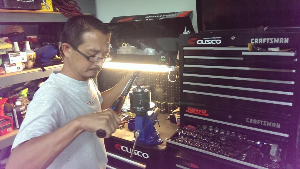

I eventually brought the diff to Kenji at Cusco USA HQ in Huntington Beach. This man is a class act. I did not buy the diff from Cusco (again it was used). I brought it to him at the end of his day and he stayed nearly 3 hours late getting it sorted out for me. Including drilling one of the screws out of the housing, because whoever put the thing together was a real fucktard. The housing bolts dont need loctite, the ring gear holds everything together when installed.
Shameless plug: Cusco (Kenji specifically) really hooked me up taking this thing apart. Putting it back together correctly, after inspecting all of the clutch plates. Then even torque testing to see it works correctly. Did I mention all this at NO charge? I WILL be buying more Cusco products as Kenji alone has bought my business.

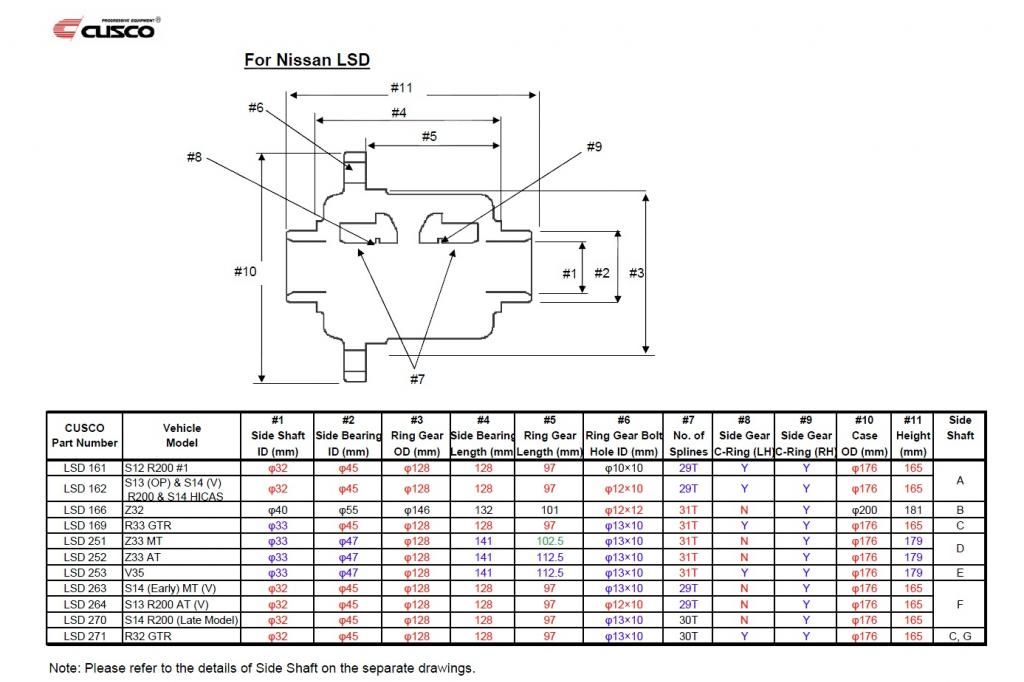

And back to real info. At first we really didn't know which diff I had. By following this chart we came to the conclusion I have an LSD 263. This alone was one of the keys to figuring things out.

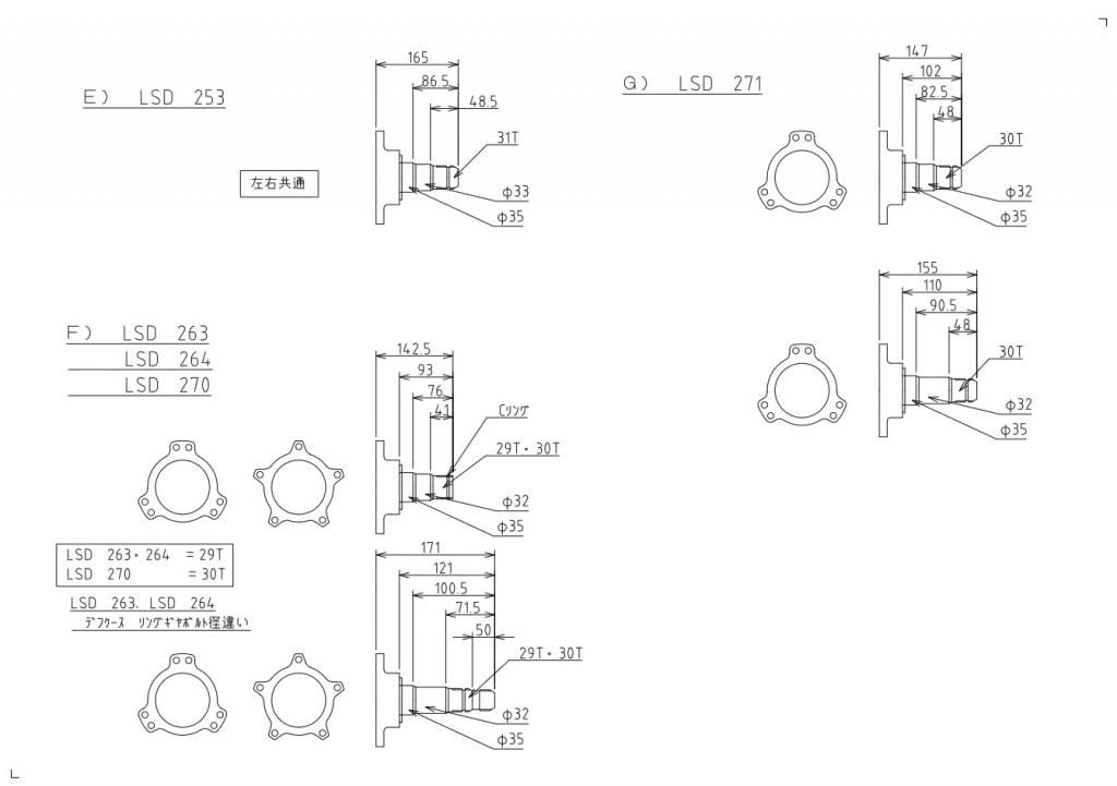

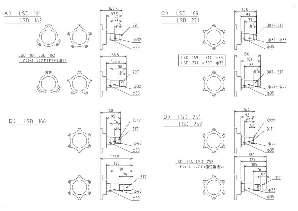

Along with that chart we used these two pages of side shaft information to determine which shafts would indeed fit correctly into these internals. In my case "F" type side shafts. These are the standard shafts in both USDM and JDM VLSD pumpkins. Only the USDM version came with 6-bolt flanges while JDM seem to have 5 bolt flanges (which I have).

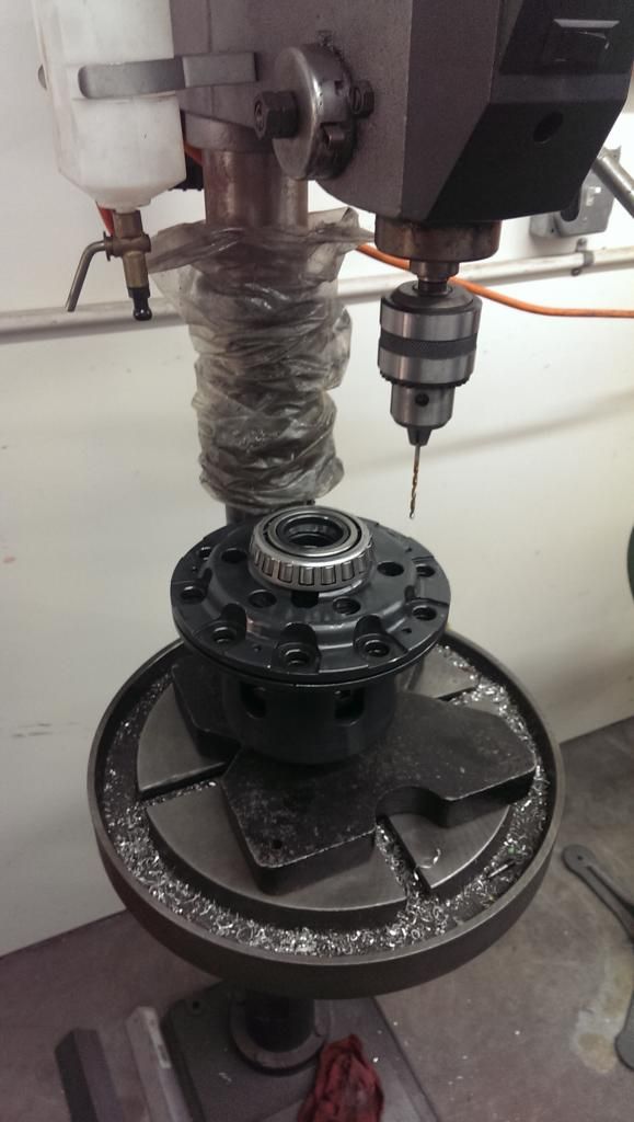

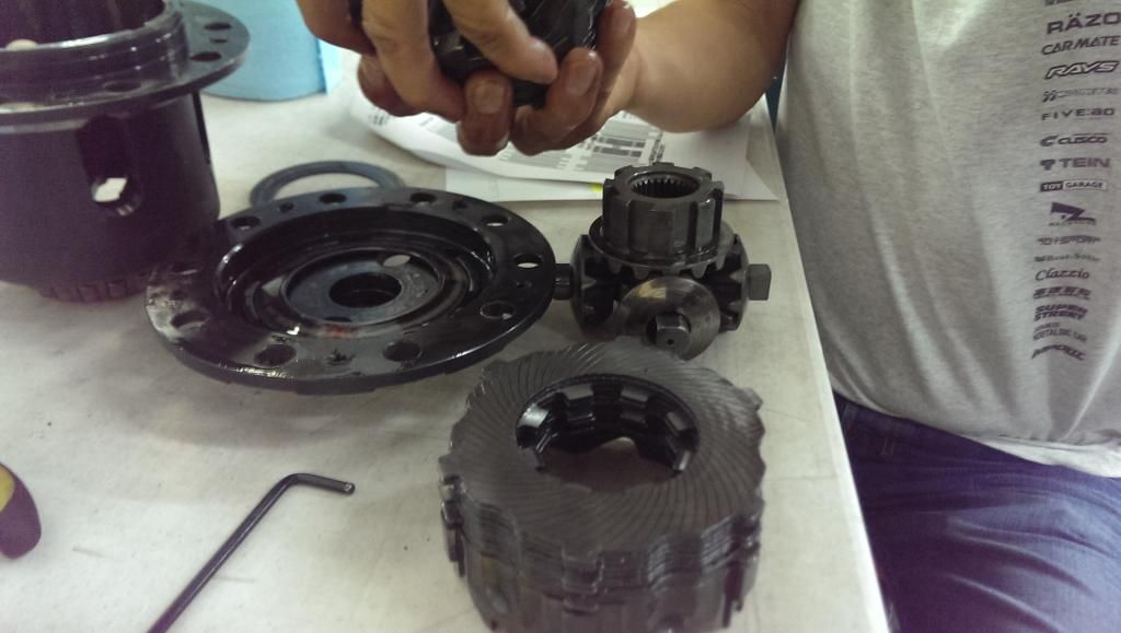

Now for picture time. First we had to drill that stuck bolt out of the housing, the bolt head completely stripped. Again, they DO NOT need to be torqued heavily or loctited, don't do it.

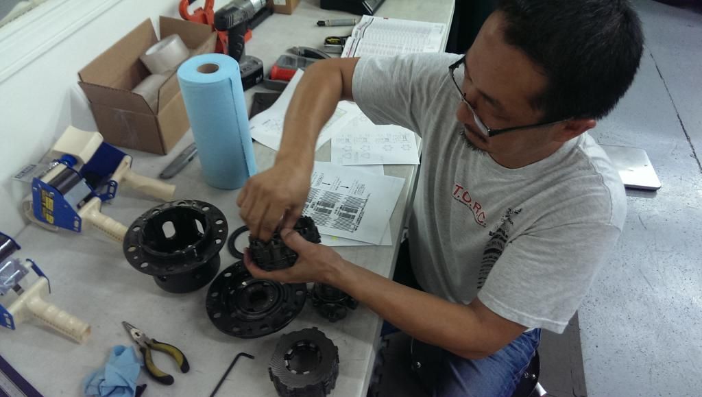

Next Kenji disassembled the entire thing and inspected all of the clutch plates.
They look good!

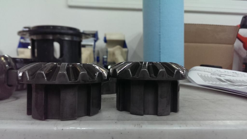

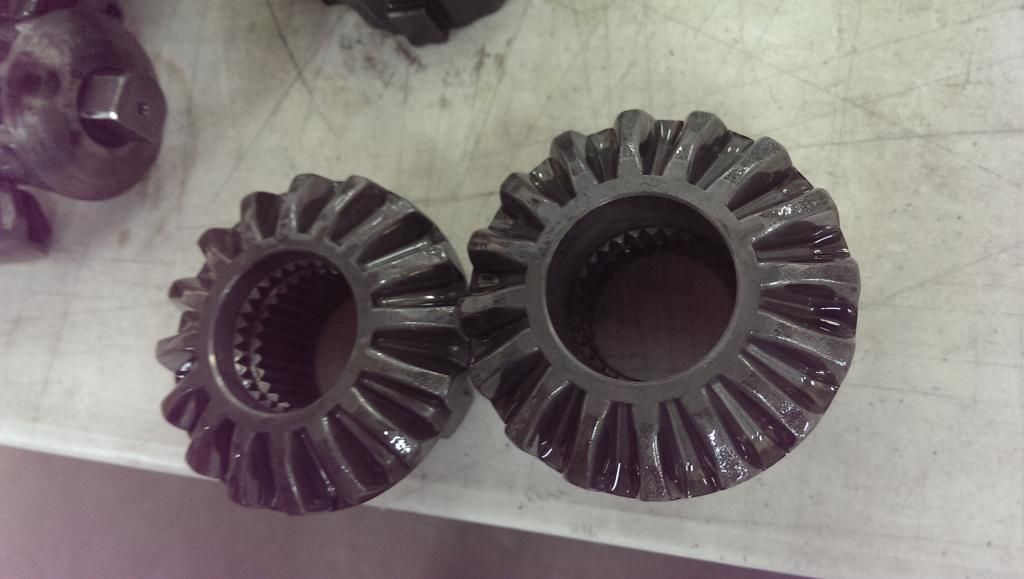

Of course these are the side gears in question. It is clear they are different and must be installed in the correct side. Keep in mind though, they CAN be installed incorrectly and the diff will both go together and function.

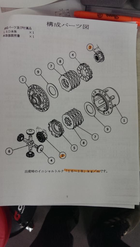

At this point all we had to do was re-build the entire thing with the side gears installed correctly. For reference here is the Cusco manual pages that indicate which gear goes on which side. This manual is only available through Cusco and it is only in Japanese.
The highlighted box with the "C" in it indicates the C clip, corresponding to side gear "2" in the previous picture. Thus the one with the C clip should be on the passenger side. As I mentioned before this was not the case.

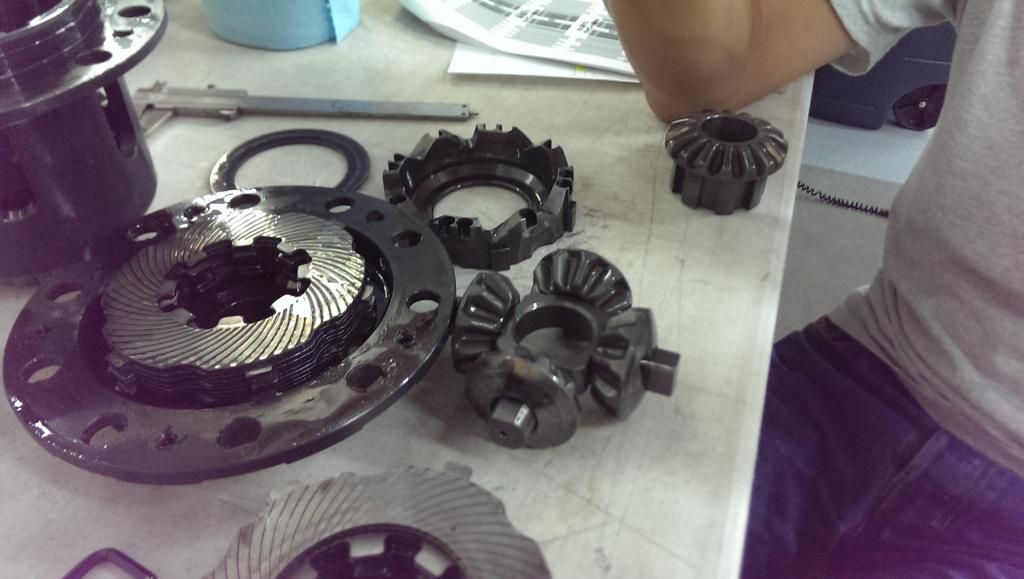

Finally. The whole thing went back together with no trouble. Kenji set the engagement to 60% for me, as this is a track and street car so I don't need really violent lock up. He even tested the torque spec to see it engaging at 60%.
