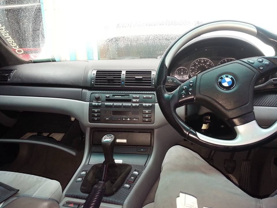

I picked this car up about 8 months ago for a decent deal. It was an ebay find it was supposed to be a good running car. It was on ebay for a while and eventually I got the seller into a price range that worked for me. I hired a transport company to ship me the car and when it showed up there were issues. However the car was still loaded with some amazing parts (10k in paint, suede headliner, MB quart speakers, tons of new suspension items, KW coilovers, Brembos, CSL trunk, OEM M3 bumper custom molded for sedan, and the roof wing.

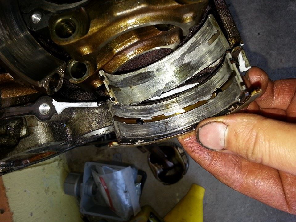

The biggest issue was rod knock galore and no oil pressure. Interior needed some help, and some aftermarket rats nest wiring, and a broken window regulator.
The mistake I ordered a replacement motor from England and imported it. Took 3 months and then once I regasketed it, and spent about 2K on the situation I could not get it to run. The new motor was a M43b19 from an e36 and the trigger wheel is aligned differently so it could not run the timing.
So im sitting in the car after I could not get the motor to run and the whole time I had the car BMW fanboys tell me noting works if you swap it. I understand the K bus and all but they say wipers, windows, all that. So I pulled the DME aka ECU and start messing with things. And it all works minus fuel pump control and AC. Since I'm RB heavy I said screw it and planned the RB swap.
I already have a RB20DET, RB25DET neo, a RWD converted RB26 trans, and a Z32 trans hanging out.
Not sure what motor I'll use at the moment but I'm going to try to use the GTR trans with the RWD transfer case. However it might be too wide at the tail so as back up I have the Z32 unit.
I contacted Dryden in AUS to get more info on their e36 RB swap kit. They never tried fitting on into a e46 before. So I ran some part numbers and my transmember is the same as e36. So I took a gamble, picked up a cheap e36 engine crossmember and the mounting and suspension points are the same. I made a test price deal with dryden for the RB swap parts, without oil pan. After looking into pans I decided I hated theirs. For the money its so ugly and basic. I found a new pan from CXracing for Z32 RB25 swap and this is the pan I decided to go with.
So right now I am waiting on parts to come in. Both 20 and 25 are apart for building. Thinking RB25 neo with long collar, jun oil pump, king bearings, stock rods (RB26), stock pistons with new rings gapped for 15 to 20psi (ring packs and lands are stronger on the neo), I have a set of tomei type A cams for it, a tomei cam gear, 3076r on a modified external gate manifold. I have so many RB parts I can build a 400 hp setup on what I have. I have R35 injectors for it, as well as a few PFC units likely run it on a r33 harness and PFC.

Curious, did the seller refund you anything for a "good running car" with bearings looking like that?

not enough but I got about 800 bucks back

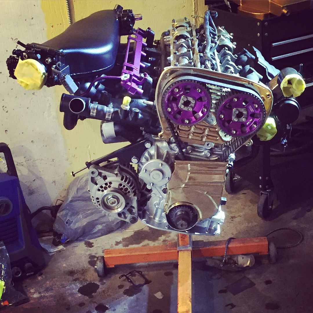

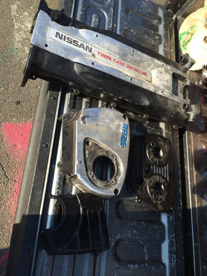

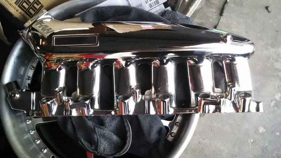

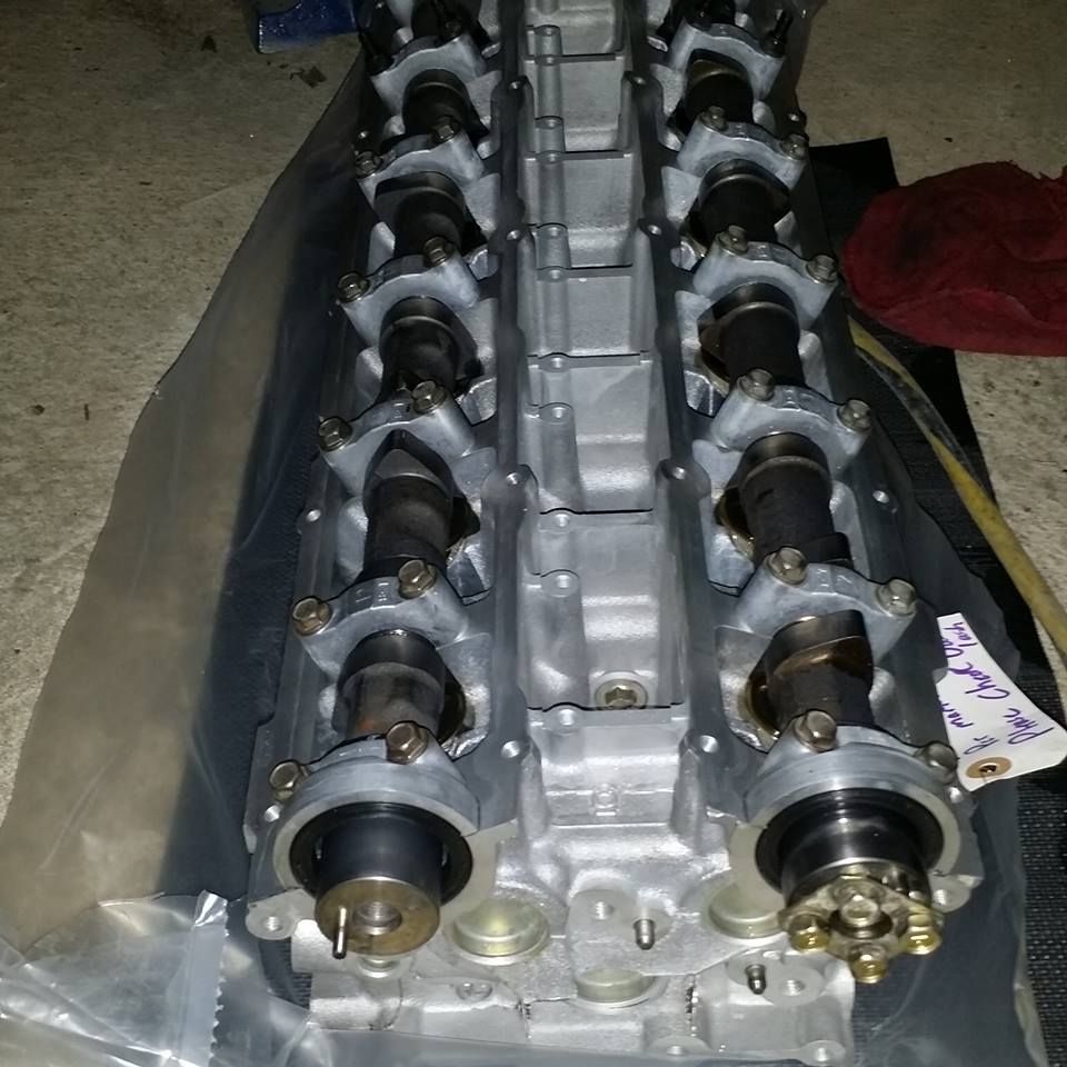

Sent these out for 24K gold plating... Not powder but plated....
The motivation

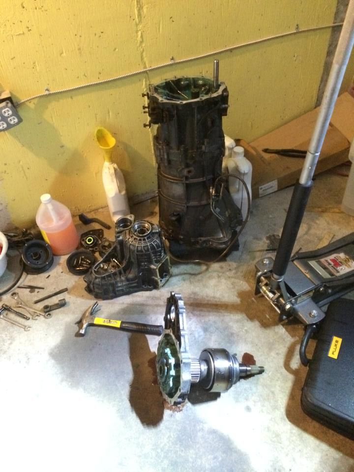

This is the RWD transfer case for the RB26 trans. It's been all cleaned up and on my trans ready to go.

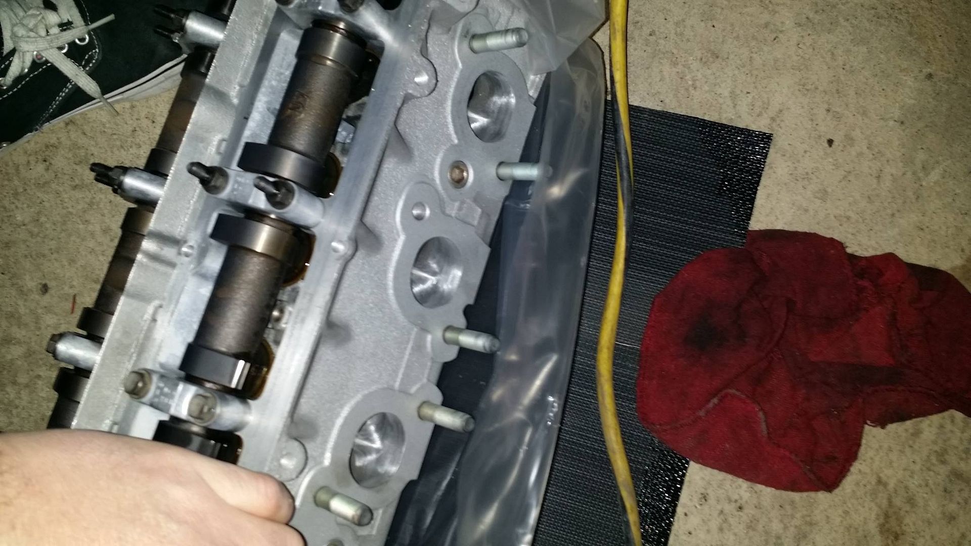

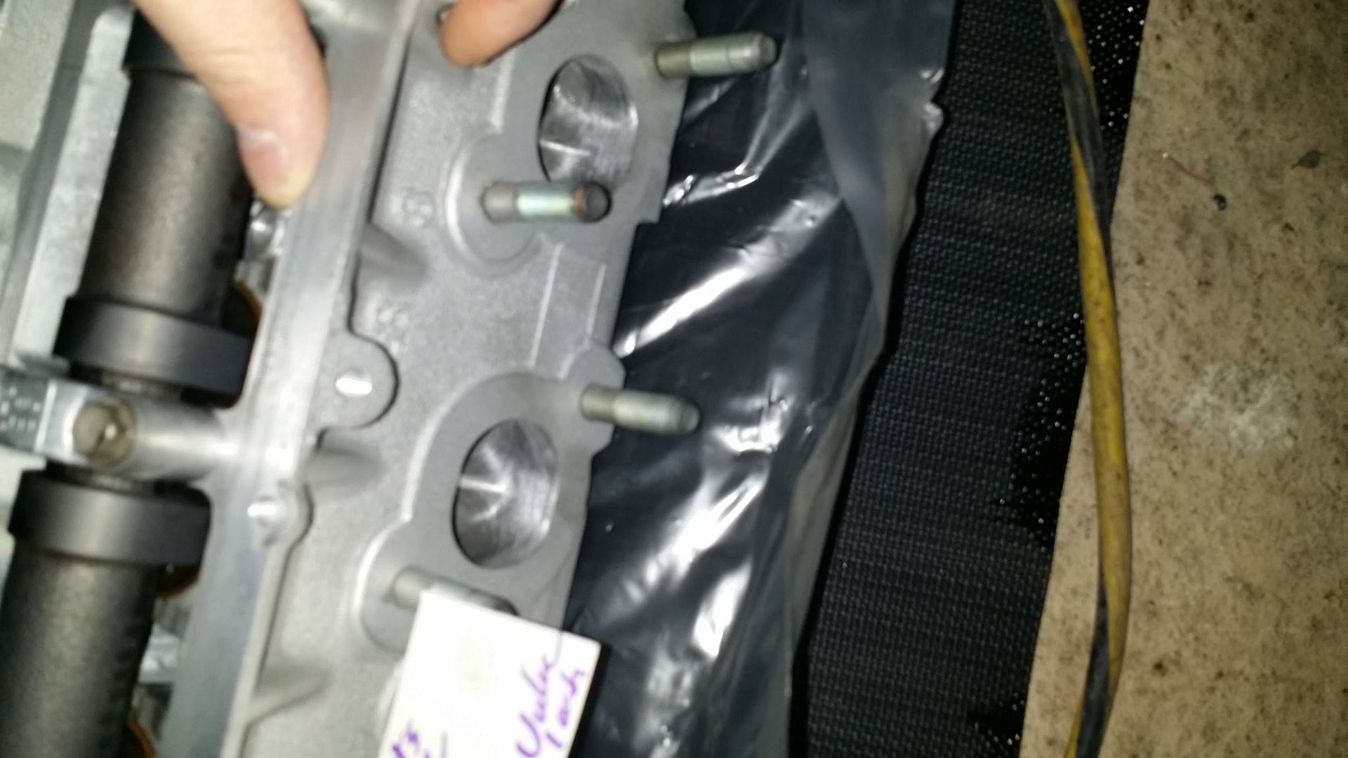

Ported the exhaust humps from this neo head. It's at the machine shop now, but wont be going in this car
Picked up this for pennies
This is the 20 going into the BMW, with some new cam gears and the gold covers.

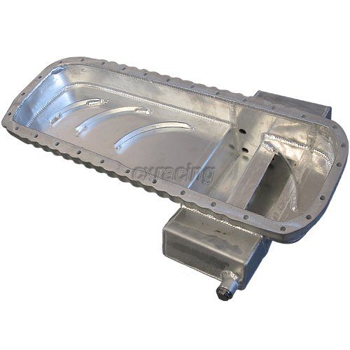

The oil pan for Z32, has trap door and comes with pick up
The mounts while will be mounted onto a crossmember and come with isolaters (TB48)
OutToWinPAHC is offline   Reply With Quote

how much did that gold dip run you, that is freaking AWESOME, and who did the work?

Unknown Coatings... He is in SLC utah but worth it. I send all my power, plating and chrome to him.

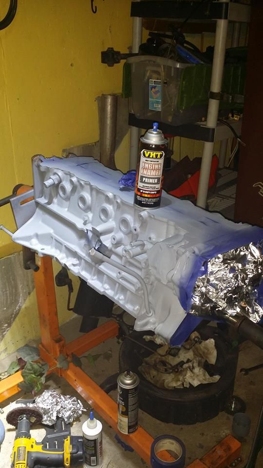

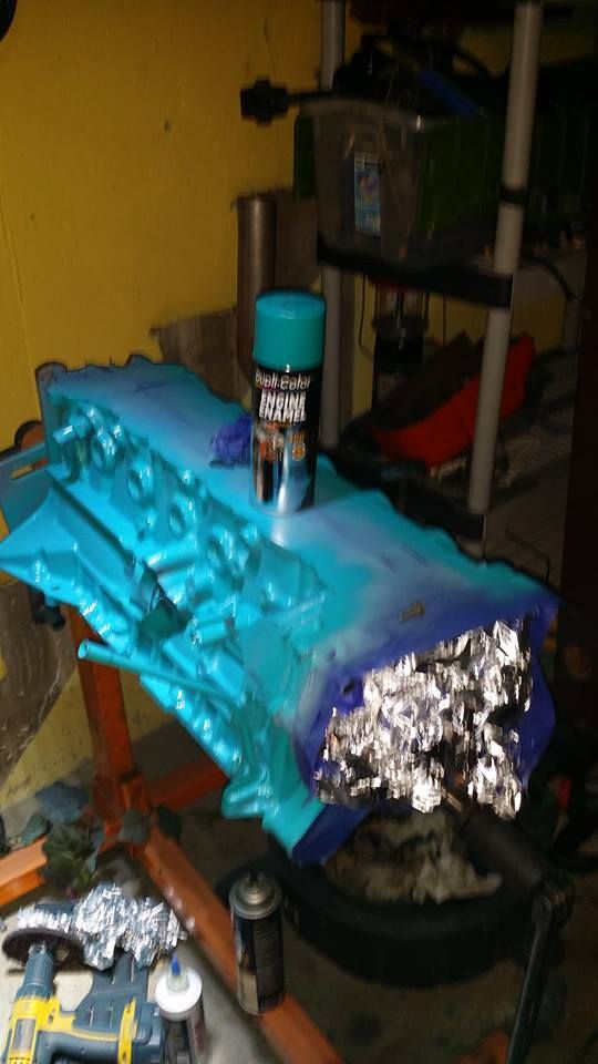

None of this is for the BMW but will be working to getting the BMW done. The R34 RB25DET is going into the car which has the RB20 now... And then I'm working on my R33 as well. As soon as the R33 is back together and tuned I can pull the motor from the R32 and start that. Once that is buttoned up its game on for the E46.
I removed and ported the exhaust side of the neo head and cleaned up the casting marks on the intake side. Then had it machined and rebuilt by BMS racing engines. New guides, milled, valve job, cleaned. I did all the porting by hand.
Block is low mile, stock. I pulled it from Akins Gold R34. We did a 800HP rb26 swap into that car and he gave me the R34 neo for helping. I painted it teal. Its got about 80K kilo, and I am using stock, block and cams, RB20 oil filter housing, JUN machine shop oil pump, OEM water pump, ARP head studs Cometic .051 head gasket aka 1.3mm, and complete oem gasket set minus HG.
And I did a much bigger cam swap in my R33 I also took my time to gasket match and port the junk greddy manifold. Yes junk they are still cast trash, just more convenient to be front facing. Anyhow it had a chrome bath.... clear coat shots arent up yet, but unknown coatings again.
