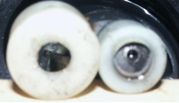

Another question. I just installed the shifter, but for some reason the plastic cap on the end of the shifter(where it connects to tranny internal linkage) is larger than the female connection on the tranny. So I took that part off, now it's metal to metal, but the shifter goes in. The throws are dramatically decreased, but is it normal to be able to lift the shifter up about 1/2" to an 1"?
I read the installs section, but it didn't say any

Another question. I just installed the shifter, but for some reason the plastic cap on the end of the shifter(where it connects to tranny internal linkage) is larger than the female connection on the tranny. So I took that part off, now it's metal to metal, but the shifter goes in snug. The throws are dramatically decreased, but is it normal to be able to lift the shifter up about 1/2" to an 1"?
I read the installs section, but it didn't say anything about having so much play when you lift it up, since the old barely had any.

You forgot to install the metal spacer ring, eh?
And for that bushing...it should be in there, just sand it down a little and pop it in. Tighter is better.

I did..it goes on the very bottem about 1/2" thick.
I'll post up a pic in a bit.

With the left cover removed, it fits in nicely. But I think that's what gives me a lil buzzing sound. The stock cover (right) I highly doubt will fit, cause the C's shifter's "ball" is about the same size is that plastic thing. I might have to force the left cover in the shifter input in order for it to fit... any other suggestions? I guess i'll try shave it down a bit to make it fit.
Another thing I might add.. Is then when it's in gear, it doesn't have any vertical play, just in neutral.
More pics...

I've had experience with a couple of C's shifters. Basically, a brand new S14 C's shifter fits all RB trannys, S13 and S14 trannys according the to owners manual just like yours.
Your looks odd though.The plastic bottom piece should not be that big at all. It should look exactly lilke the stock piece. Also, the square machined metal piece looks a bit thick. Here is an example of an S13/S14 C's that fits perfect (I bought this particular one myself from Japan):
I would almost be 100% convinced that it would fit without problems looking at that chassis list, but the physical aspects of the shifter just don't look right. That plastic piece makes all the shifts very snug and eliminates any play.
TurDz is offline   Reply With Quote

Well with the bottem piece removed, it works fine. I took your advice on the redline heavy gear oil, and it seems to work well. Not that there were any problems from before. Pretty much preventive maintainence.
