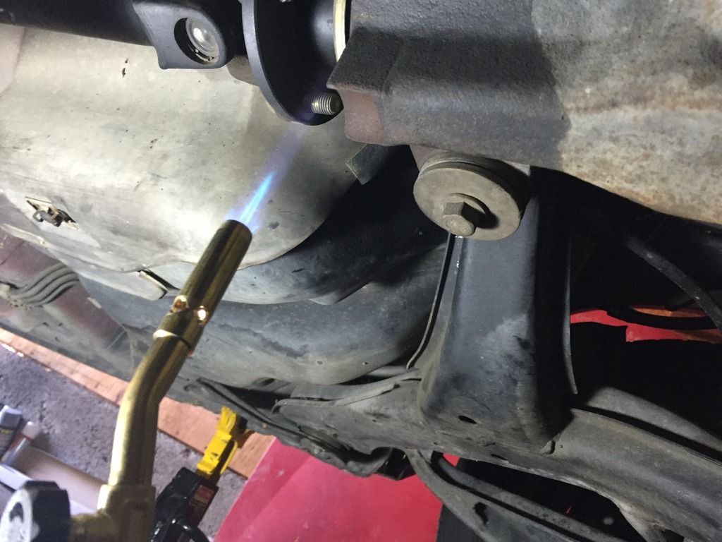

I chose to remove the drive shaft from the diff so I can remove the complete subframe with all arms/parts still attached. If you absolutely have to use a torch like I did to remove the bolts, PLEASE PLEASE be careful as you're right under the gas tank......Please inspect your tank thoroughly before attempting this. A leaky tank = boom. My bolts/nuts were 14mm.

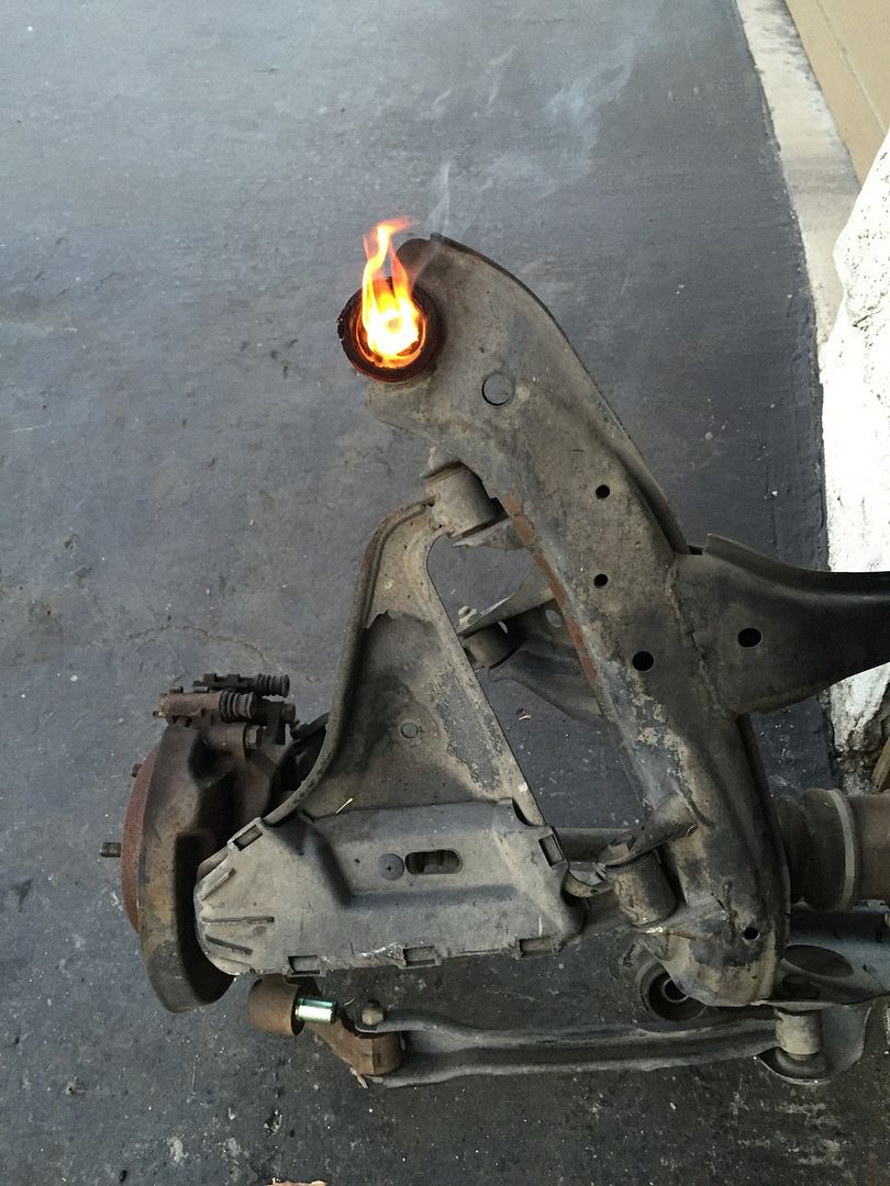

What I chose to do at this point was to use my torch to burn the remaining bushing as much as I could before I went at it with the drill/wire wheel. The wire wheel honestly does wonders. This is what it will look like when all the remains of the oem bushing are removed.

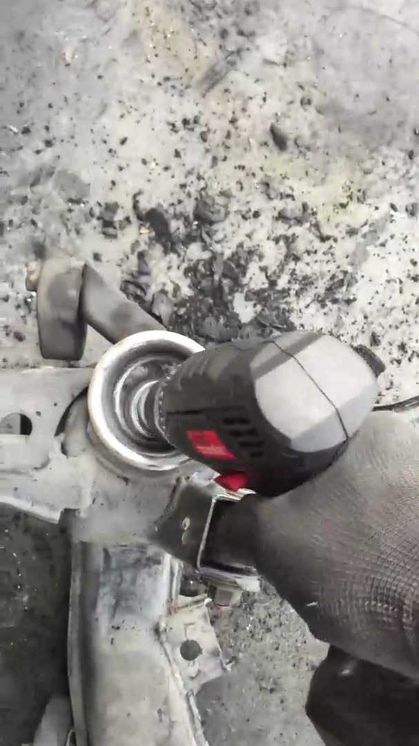

Next, I took the drill/wire wheel and went to town! Cleaned it up real nice and make sure it was basically free of debris. (yes pic is of the rear one here, but I did this process for all, just happened to only snap a pic for the rears as I was finishing up the last bushing.
That little pic is actually a video lol

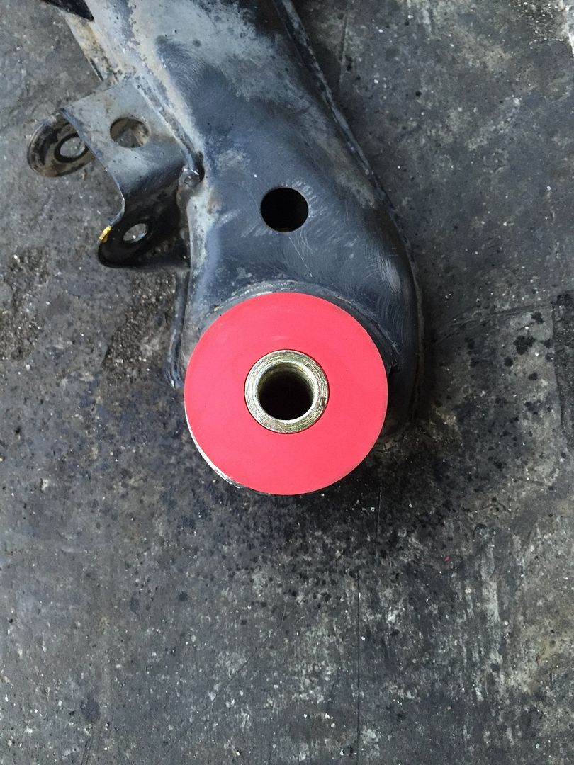

Once clean, go ahead and lube the inside a tad to make it a bit easier to get the bushings in. Do the top first, then the bottom side.
Repeat for the other front side!
For the rears, it's actually a lot easier as you don't have to bang out any collars and it doesn't require any sawing of anything either. PLEASE MAKE SURE TO KEEP THE LIP ON THE BOTTOM for the rears just as you did for the fronts. You need them! Remove the old oem bushing; again I used fire and the wire wheel . Once cleaned, lube the subframe/bushing a tad to make life easier and put in your bushings.
