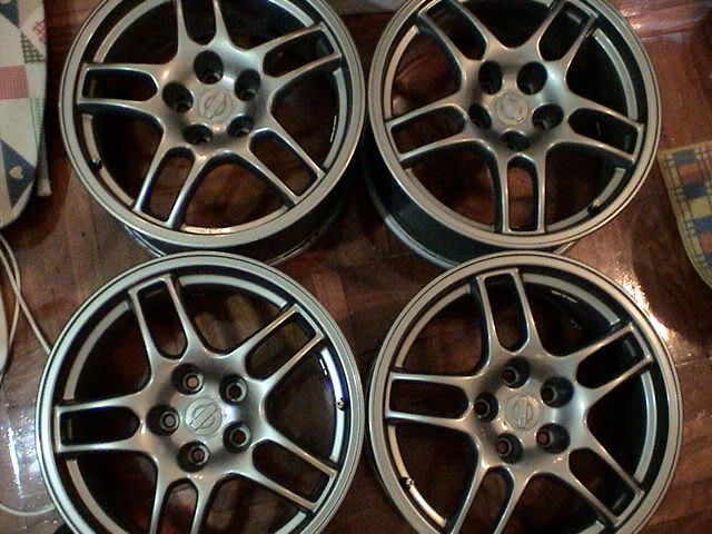

Hey everyone, I recently purchased a set of R33 GTR wheels for my S14. I just have some questions about how to get the best look and fitment.
1) What size of tires should I run on them?
2) What size of spacer should I run to make them as flush as possible? Also, should I run a different size on the front than on the back?
3) Once I order SPL's coilovers will I be able to go quite low without having to pull or roll the fenders and what kind of camber will I have to run?
Thanks in advance.
Neil
