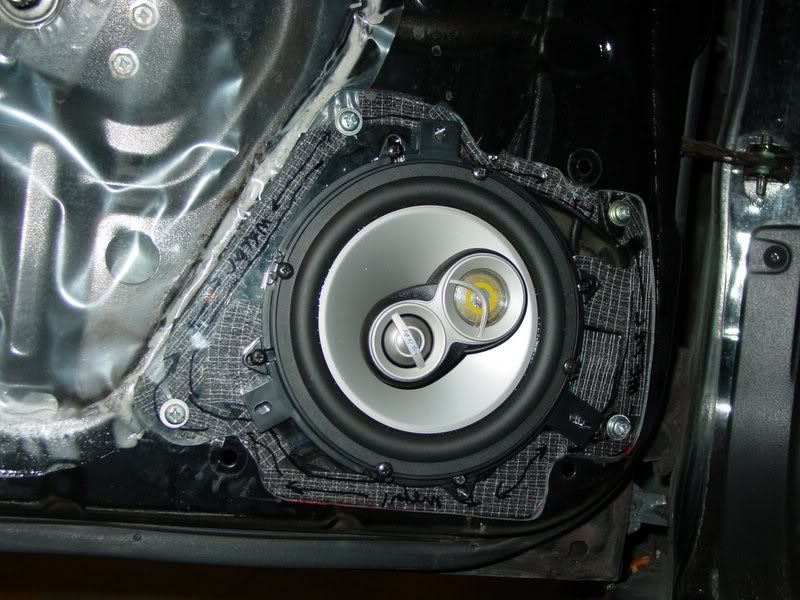

infinity kappa 6.5s in the s13 door

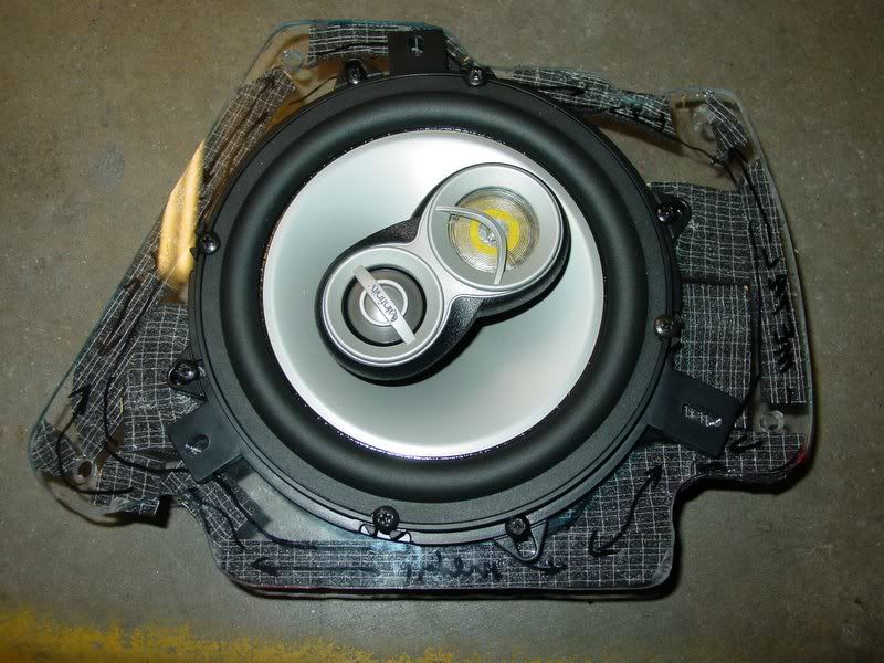

Yup they sound dope. They're the 3ways, I got em off ebay for around $120 shipped. I made some plexi baffles to mount them in and just wanted to share a few pics I snapped... BTW the plaid lookin stuff is 1/8" thick foam tape, it's on the back side of the glass. It causes the plate to seal good against the metal door skeleton, and the foam also eliminates any resonance they might have otherwise....
They sound 1000 times better than the blown 4x6 shit that was in there. They clear the window and door panel with ease. I'm sure someone out there is thinking of doing something like this too, I say go for it you will not be disappointed.
