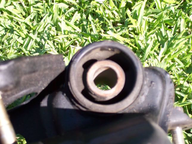

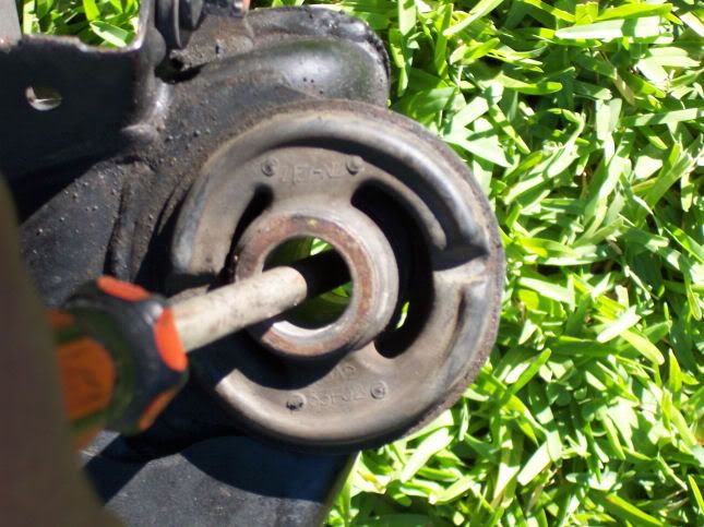

i filled mine with poopoo brown polyeurathane (sp?) and greg dupree (i think) spacers.
Tough as door nails
i mean look at all that room!
and twisting
Keep it Classy
