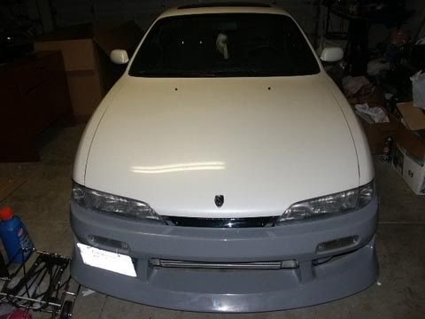

No bumper support it is. Oh, and since you have Uras, are the sides of the front bumper supposed to line up flush with the fender?
Ben Schwartz's S14 with Origin Aero
Maybe it's a Kouki only thing? But see, Ben Shwartz's front bumper lines up with his fender, but he also has overfenders. I read somewhere that Uras/Version III/Aggressive only lines up with over fenders?

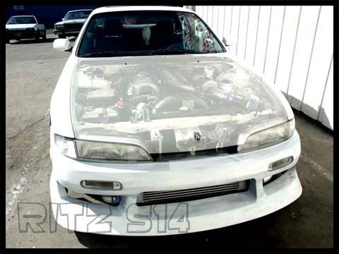

Ritz S14
Ritz S14's Avatar
Join Date: Jul 2004
Location: C A L I F O R N I A
Posts: 3,586
Mine fits flush..

Old 11-23-2005, 08:27 PM   #10
Ritz S14
Ritz S14's Avatar
Join Date: Jul 2004
Posts: 3,586
Yes it's off.. just click the pics to enlarge my friend
