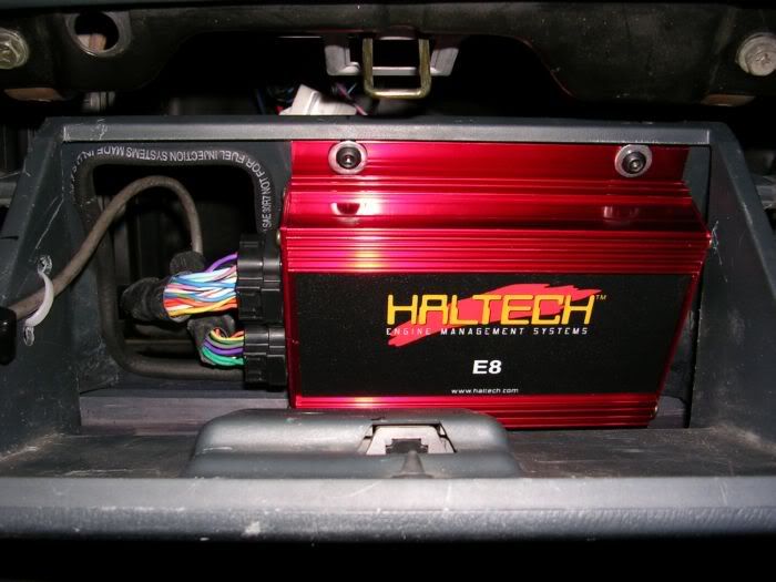

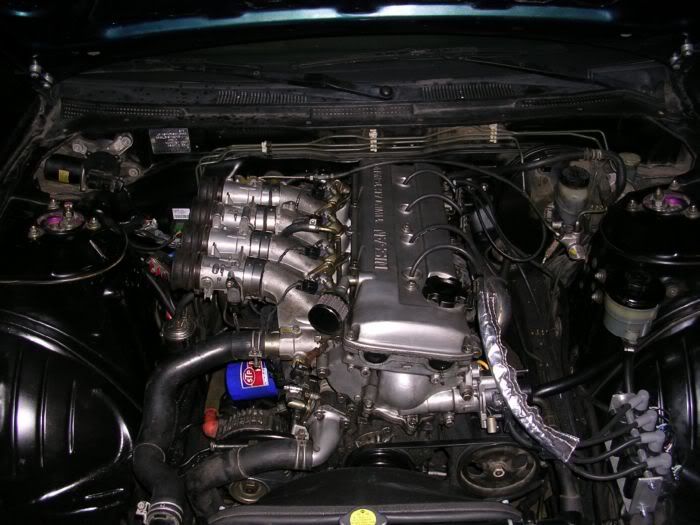

the haltech installed. where is it? haha hid all the wires!

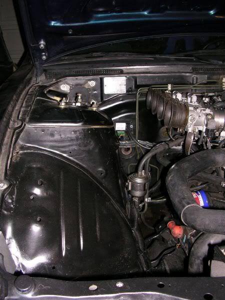

ran the harness under the manifold. You can see the wires all heat shrunk.

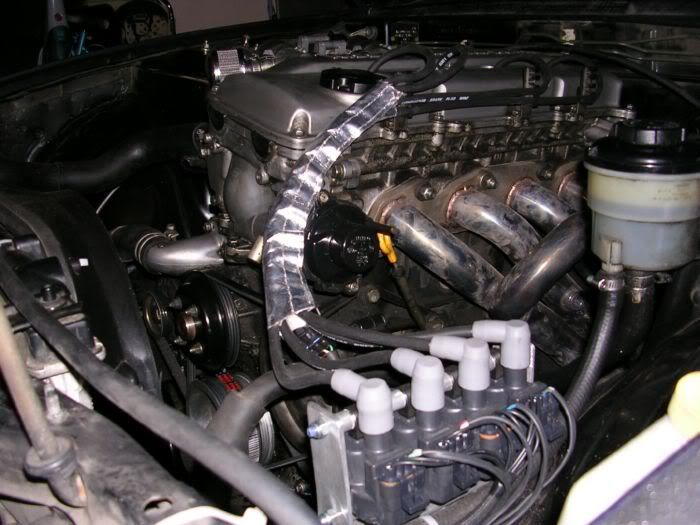

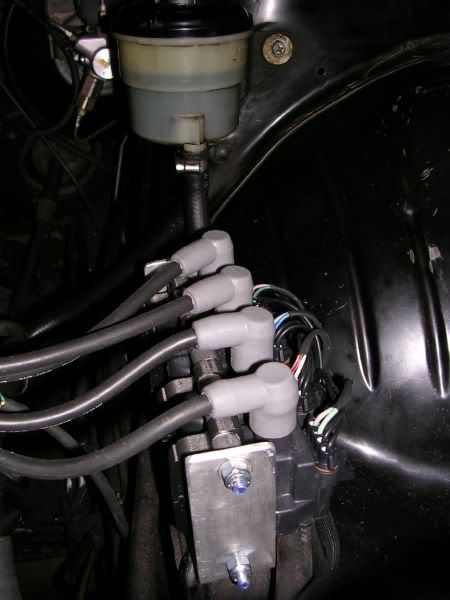

The LS1 coils and wires and whatnot. Made a cool aluminum bracket for them too.
coils up close

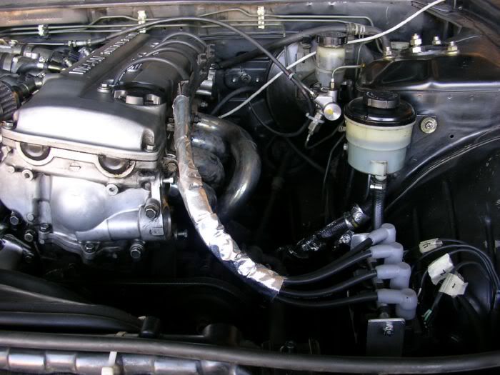

another...

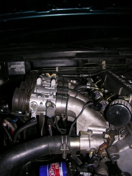

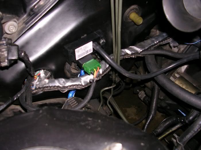

a closeup of the map sensor, harness in its heat wrap, and distribution block

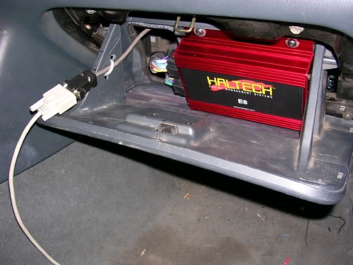

Where else would you put the ECU? hahaha I love it!
And for shits and giggles...

Old 12-14-2005, 02:02 PM   #25
NemeGuero
No more nissan.
NemeGuero's Avatar
Location: RAIN, Washington.
Posts: 8,132
Gawd damn thats bad ass.
Where did you put the fuse box? And what did you trim out of the engine harness?
How hard was it to relocate?
NemeGuero is offline   Reply With Quote
Old 12-14-2005, 03:23 PM   #26
meatish
meatish's Avatar
Join Date: Feb 2004
Location: san diego
Posts: 382
meatish is a well-known jackass
Mmmm LS1 coils.. i love your ignition setup.

Old 12-14-2005, 07:38 PM   #29
Al_S14
Al_S14's Avatar
Location: Chesapeake VA
Posts: 405
Al_S14 is an unknown quantity at this point
Send a message via AIM to Al_S14 Send a message via MSN to Al_S14
how do you regulate idle air flow with out the IAC?
