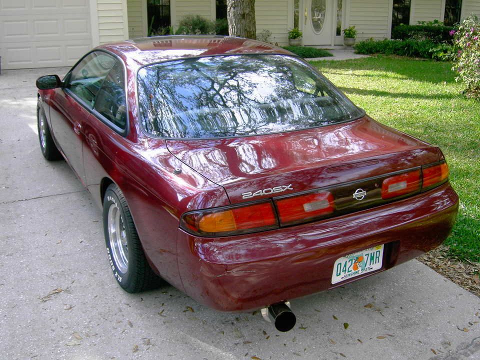

to borrow from the picture thread...
rbs14's car:
fn01rc 9"+15mm
9" +15 outer clearance should be the same as an 8" +2mm
if you think that's sticking out too much, that's your call.
edit: closest i could find. 15x8 +0mm (supposedly). it should give you an idea of how they'll sit, at any rate. good luck with whatever you end up doing.
God thats an ugly picture of my s14...lol
Yeah, those are 8 inchers, +0 offset. It was lowered on Eibach sportlines and agx's, if you were on coilovers you might have to roll the fenders, but I doubt youd need any pulling.
