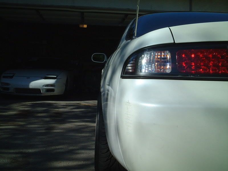

I have 17x9 CR Kais in +17 offset on an S14 with Tein SuperStreet coilovers....clear the coiloivers fine...
Rolled the fenders so that the tire wouldn't rub on severe compression stroke
I think they fit perfectly to be honest....

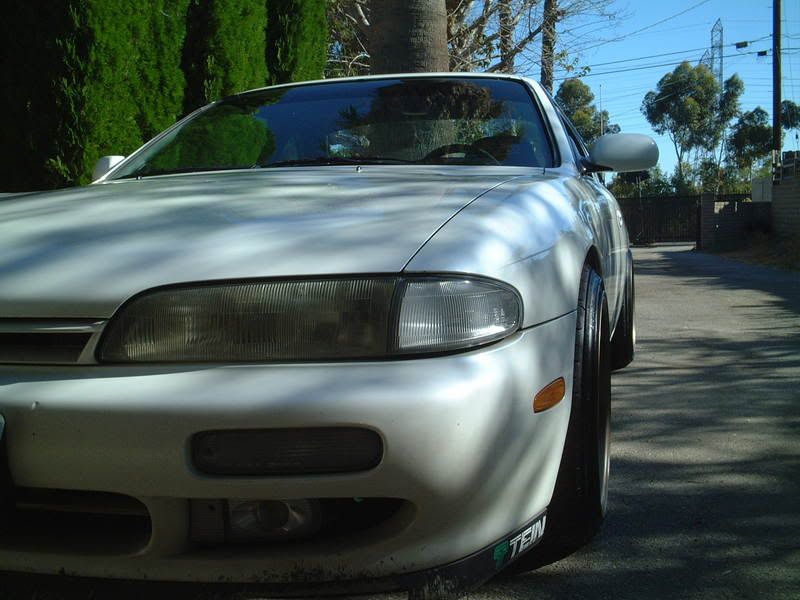

here is an example of 18x9.5 with a +28mm offset. note: pics taken w/o battleversion RUCA or any adjustment to stock RUCA

^ wow that sticks out a ton....are you sure on the size...?
18x9.5 +28 should stick out the same as (anything)x9 +22
However, my 17x9s +17 dont stick out anywhere that much....it looks like if you lowered it the rim would hit the fender
If its a real 9.5j at that offset, that should be hitting if not close to hitting coilovers.

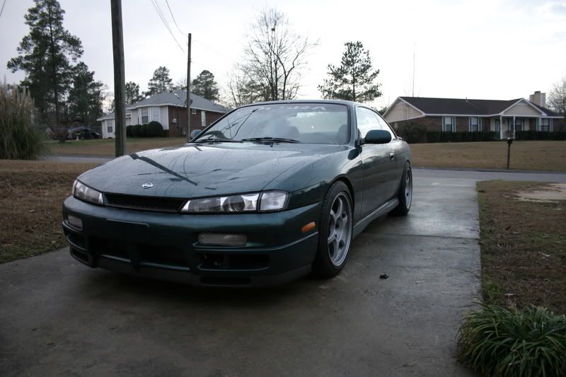

17x9 +15 in the rear 17x8 + 15 front. best pic.. lowered on Tein HE's rear had to be rolled slightly everything else was fine.

^ Sick Kouki!!! Yeah, I am surprised how flush the front are (no spacer??)
PS I love that color on koukis
