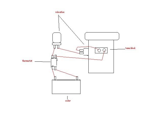

like this...
not to scale.

aaaaaaaaalmost
Filter relocation is just one piece. The Tomei block goes instead of the thread on oil filter part.
If you look in the pics above (kilgers)
Tomei block, to filter, to thermo to cooler, to thermo, to tomei
running -8or-10 lines.
Edit.
here it is, from Tomei website
Oil block installed
Oil filter relocation kit with cooler (no thermo, just like my setup)
hope that clears it up

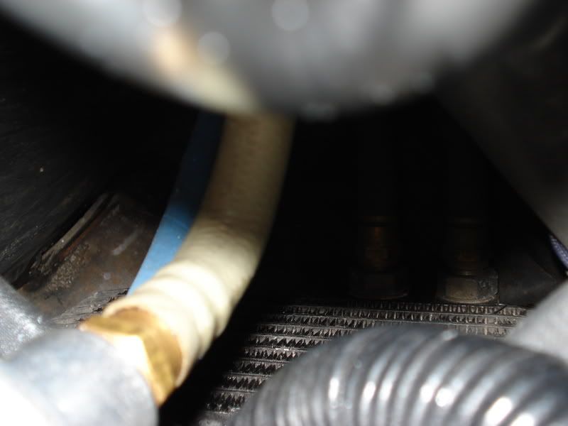

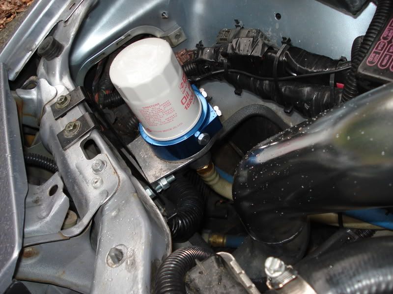

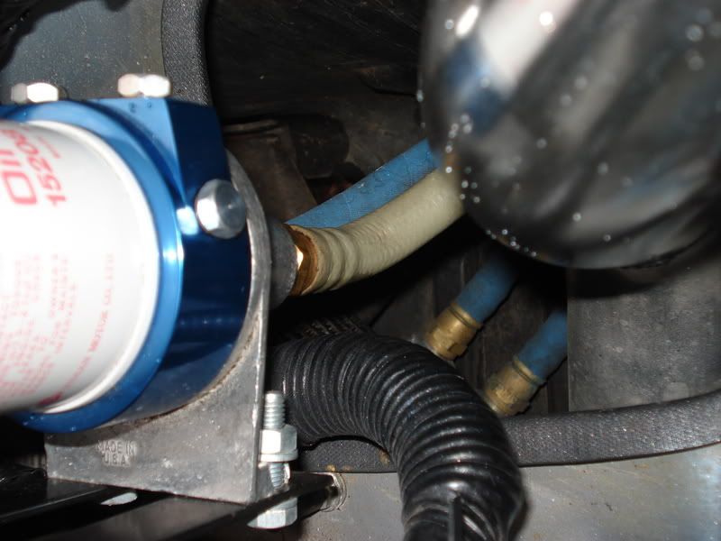

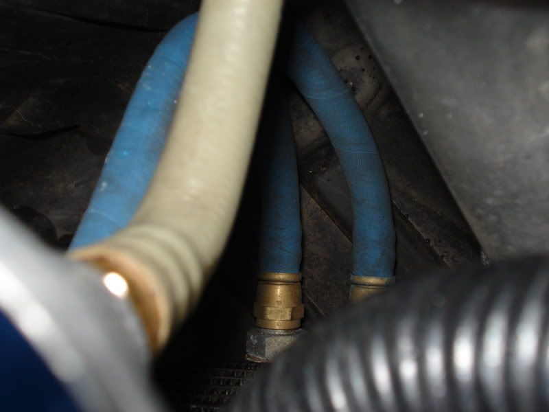

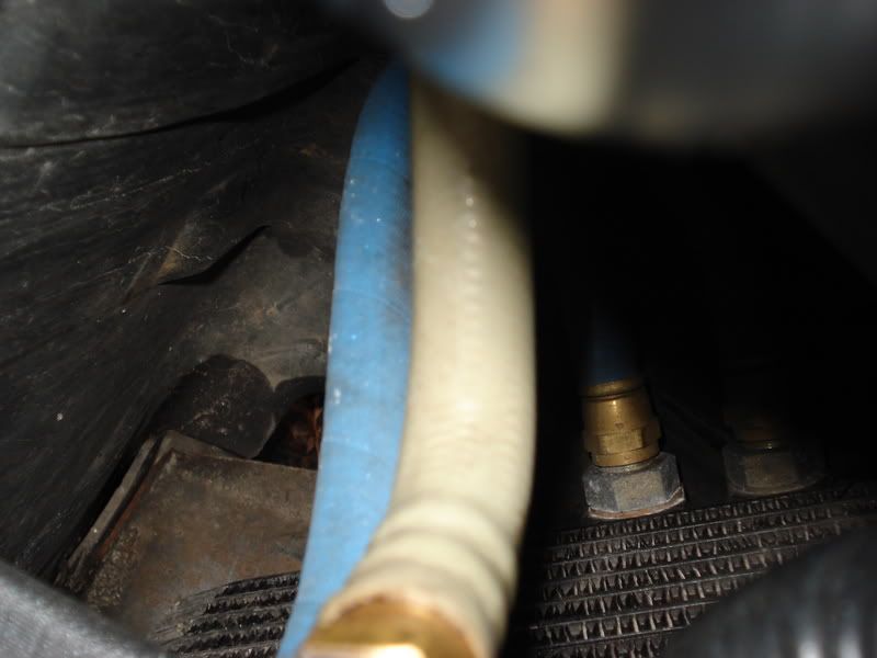

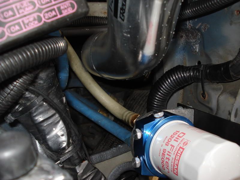

SR oil cooler set up
I highly recommend either a built in thermostat to the oil cooler itself or an external one. you can still run without a thermostat but thats like taking the chance when you bounce your sr off the red line with no RAS!!
Once oil reaches a good opp temp the thermostat opens up and allows oil to circulate through the cooler. When the oil is not warm enough it simply bypasses the cooler and shoots back to the block and circulates as a normal set up would until it warms up to pass through the entire oil cooling system.
Thermostats are good in that there is no forcing the cold thick oil through very small bars on the cooler.
I have an oil cooler with a built in thermostat here is my set up
hope these pics help
Its a good idea if you do this set up to have the feed and return lines a different colors or marked ( makes it quicker to source potential problems, and with a spagetti of hoses to know wich line does what.
on my set up the grey is the out to filter from engine, short blue from filter to cooler thermostat, long blue back to engine from cooler.
hope that helps
