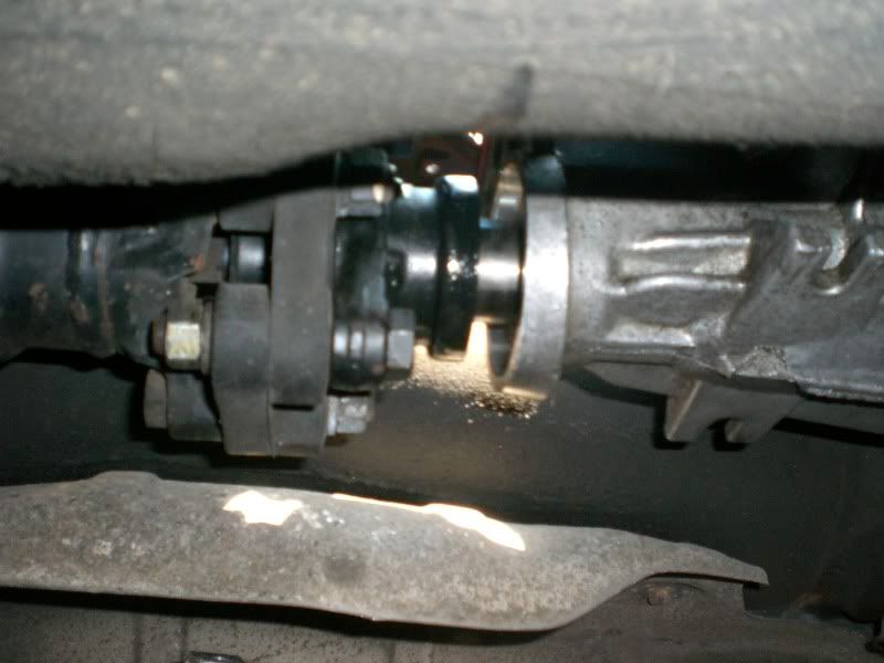

driveshaft problem(pics)
I've search but couldn't find my answer, i install my sr20 in my 90 coupe and the shaft has space between it and the tranny. I don't remember it being that much space when i had my sr in my 93 coupe, is this normal? everything is bolted up too.

I've seen the same thing on multiple cars. it's got enough inside that I wouldnt worry about it

its fine
you could have an ABS D/S in a non ABS chassis
other than that you have more than enough of the D/S shaft in the tranny
is the car on the gound in the pics?

Originally Posted by Sileighty_85 View Post
its fine
When you lower the car on the ground it will push the D/S a little more in to the tranny
i doubt i have a abs d/s cause i bought the car from the original owner which was a old lady, she left the car bone stock when i got it...the car is in the ground in the pics...you think i should put the dust shield on it to protect it from debris? i still have the sr one and i could trim it to size to make it fit.

After searching around I found out that I do have a abs driveshaft in my non abs chassis...I heard it will fine but the only thing is that i can't punch it when I'm driving it...is this true? Would I be better off getting a non abs driveshaft to be safe and avoid any damage to the driveshaft or tranny?

i saw a product a company made to where it was a ABS D/S spacer thatyou sandwitched inbetween the diff and D/S

Neither of that... THat is a NORMAL space, because he didn't put the dust ring on, or lost the dust ring, which normaly would cover that space.

I don't have the dust ring installed on mine and my DSS driveshaft seats all the way in.

Yea it seems the dust ring is missing on the tranny, just slap on a later model of the j30 vlsd like a 95-96 so that it has the 6 bolt output for direct bolt on. The abs sensor on the pumpkin will fill in that gap and your driving will be a little more fun.

Don't put a non abs drive shaft on a abs diff. On stock the balance of the center carrier is going to be thrown off.
DSS is different, single piece and btw I have a DSS and it doesn't seat all the way in. ABS drive shaft on ABS diff, but is perfectly covered by my dust ring.

100% correct. That is normal, what isnt normal is if its flush without the dust collar.
I removed my dust collar, couldnt get the 1pc on with it attached.
OP you have the correct setup, no worries
