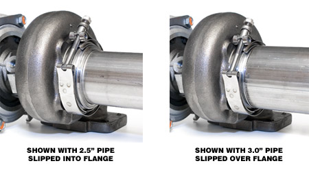

I don't know if you saw that atp makes a flange that fits on the t25 plus housing and excepts 3" exhaust pipe. Because we are still bottom mount i know theres not to much room between the turbo and firewall, so if the 2.5 to 3" flange adapter doesn't work out, check these out.
Yeah I saw that, thanks!
The adapter fits just fine, ill just have to swap the 3" v-band flange to another style that I got from Burnsstainless.com. I don't know if Ill be able to get on this project this year, there's a lot of stuff that needs money right now, lol.
