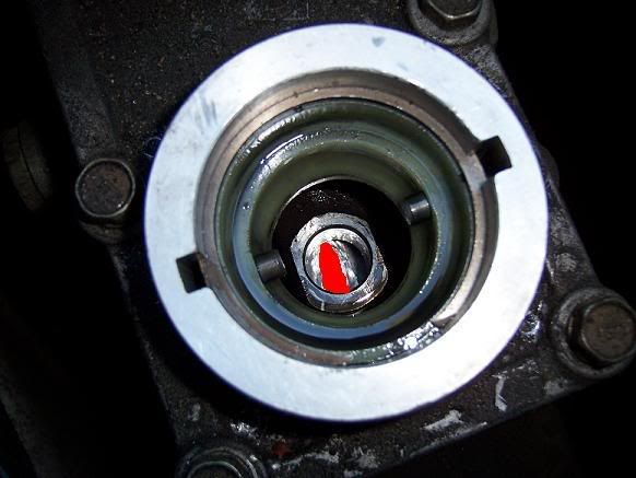

Has anyone here experienced grinding when they shift with the B&M short shifter for s13?
I currently have a aftermarket(dono what brand) short shifter on...and it grinds occasionally when i shift into 1st, 2nd and reverse...i am sure its the short shifter because when i put the stock one back on...it doesnt grind...So i happened to take out the aftermarket short shifter today and found out the bushing was broken into 2 pieces...
heres a pic of what the short shifter has done...
i donno if this is normal wear...Right now, I am just thinking about replacing that crappy short shifter that I have with a B&M one.

Thnx, but i have tried to put my stock shifter's bushing on the aftermarket shifter...and what happened was that I couldnt even shift into first gear... =(
just to clarify on the part where i think the short shifter is wearing down...(colored in red)

Yeah, that wear is definately NOT normal. Even my 140K+ mile tranny still looks brand new.

If you white bushing cracked, that mean the grinding down you see is caused by the metal on metal contact.
You might also have problems with the gears in your tranny.

yea your synco's are probably on their way out, its a common problem with 240's

It's a common problem with all high mileage transmissions. Not just 240's.
I have a B&M knock-off and it's been working good for about 2 years now I think. I would try changing the fluid in your tranny at the same time. It does wonders for shifting if the fluid in there is old.
