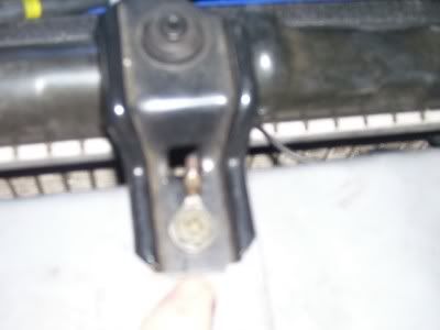

Originally Posted by 240silvia
He doesn't have the clutch fan on the car.....
Next.... lol.
Sterling this is the longest problem I've ever seen.
Your just retarded with bad rep anyways.
Next.... lol.
Well obviously to have this thread go on for so many pages just makes you incompetent. If the ecu throws out a code saying it's the MAF, it is something with the MAF. Just to help you out a bit you probably have a faulty ground. Within the three wires there is a Black with white strip, a white wire and an all black wire. More than likely you have a faulty ground that needs to be bypassed (this would be the black wire).
Sorry if the pics are shitty, but I have had to do this on a few s13's. Mine happens to be one of them.
Then properly ground out to the chassis.
It doesnt hurt to bypass the ground. It will save you a headache from buying a volt meter.
There you go I am tired of spoon feeding.

Well then it said 55(OK), I just checked it again and got 11 CPS. I checked all grounds and their good. Just in case Ill check it again when its light. Thank you sir, I will do that tomarrow and tell you if it does it.

I grounded the MAF same spot and made sure no paint or corrosion blocked it and it is still acting retarded. Step 1 buy multi meter, Step 2 test TPS, Step 3 test CTS, Step 4 new MAF, Step 5 part out KA and buy newer one. Oh before step 5 I'll send injectors out by that recommended site.
