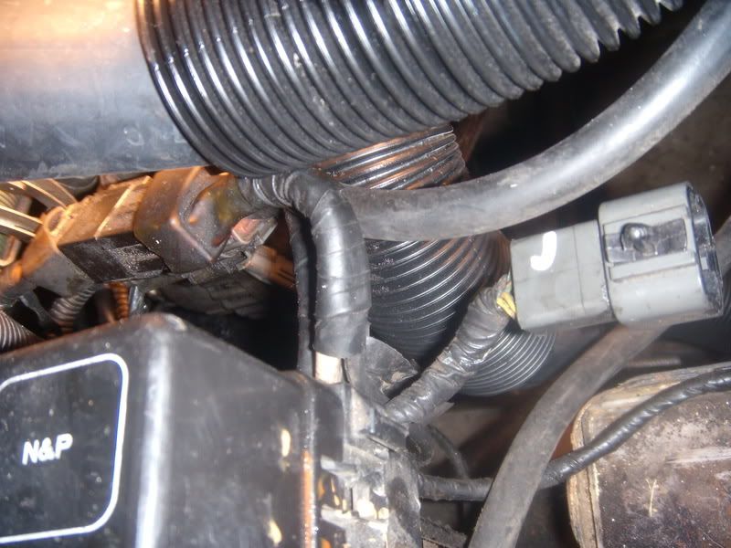

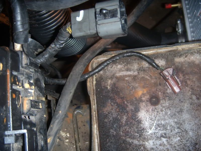

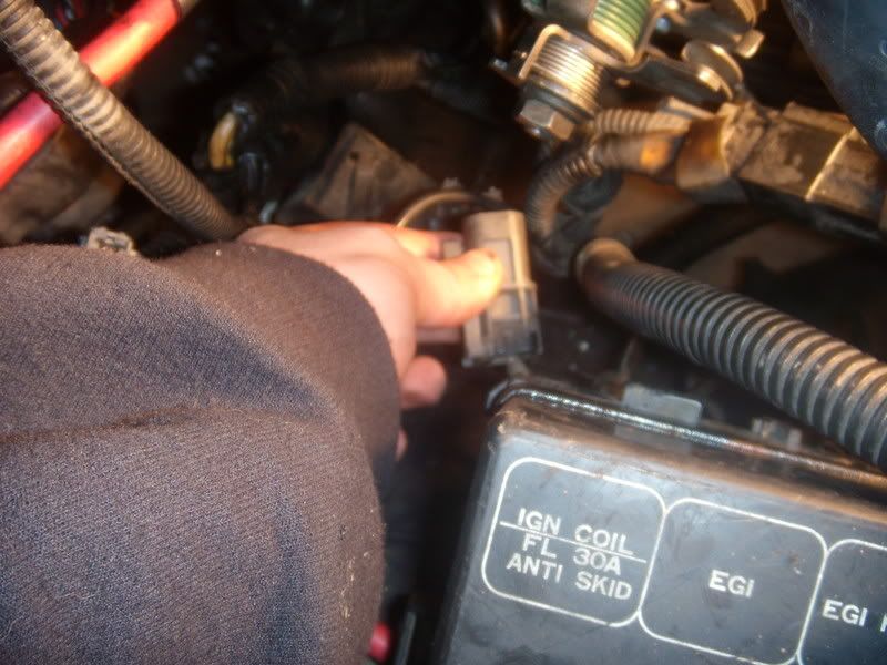

the 40 i got the harness off of had 2 lower harnesses. the normal 1 that connected to starter/battery/alt/tran and the 2nd one which connected to the rest of the tranny and then i think maybe the rest of the fuse box but idk.

found out that the brown connector in the 3rd pic goes to the a/c condensor. the other 2?

A/C drier, yes. Not needed. The other two are transmission and oil pressure sender. I don't recall the exact pinouts but you only need the VSS from those two plugs.
