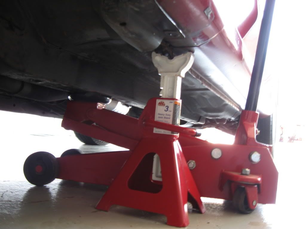

Okay, here is a picture of where i jacked it up and placed the jack stand when replacing front driver side rotor. Tell me if this is correct positioning.
CoreyS13 is offline   Reply With Quote

that is NOT the correct place.

Please correct that then should I be jacking farther to the front or what?

jack up the front from the front crossmember. the rear jack it up from the diff
