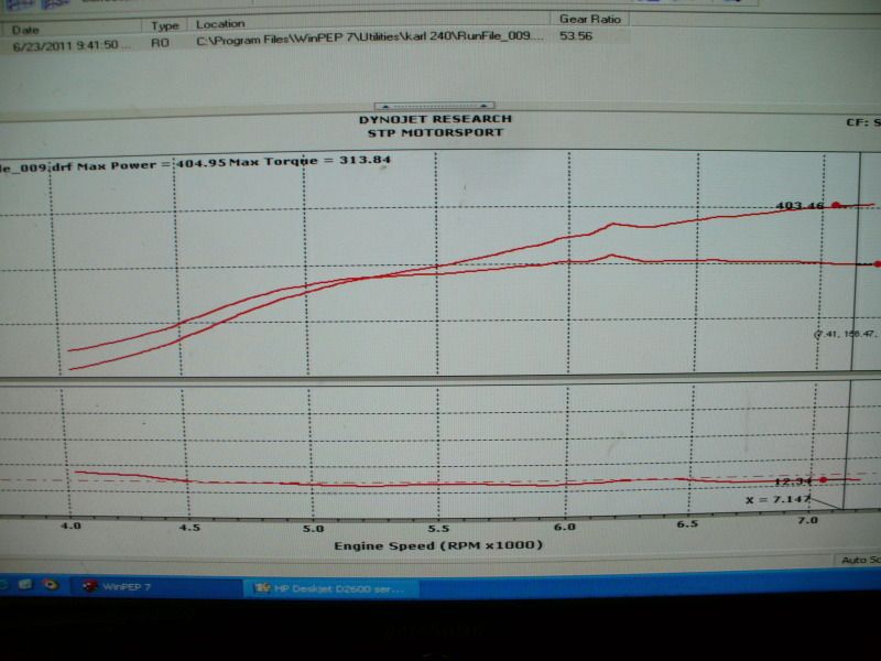

Update. Got on the Dyno again I don't believe the car was building full boost last time on the Dynojet. I was able to get on a Mustang Dyno and got the car to hold 25 psi. After a short spike to 28 which caused a jump in torque. But either way I was impressed by the numbers. I have also switched to BC 264 cams since last time. 458whp 479wtq

Well, as luck my have it, I may have a very nice, very solid GTX2867R setup with OEM manifold and Tial MVS wastegate for sale here shortly... Setup made 418whp on pump gas.

Im targeting 400 WHP on 93 octane (Yes, stock internals). There will be very apporiate tuning done, by me.

Originally Posted by Jorgs_7 View Post
After being in the game that long, I dont doubt you on the piston thing.
I appreciate it!
As far as particulars to your set up:
What size cold/hot side piping were you running for your FMIC?
What PSI were you running when you made 419 WHP?
Do you have an opinion on the JWT S3/S4 cam arguement?
Thanks man.
(Not trying to hi-jack the thread, but hope other people can benefit off the 400 WHP .64 housing T2 details)
Hot pipe = 2.25"
Intercooler: 2.5"
Cold pipe: 2.75"
Inlet pipe: 3"
22psi with meth/water
I've only had S3, never had S4.
-Kyle

In the same regard, 'custom tunes' can often hide problems, and or make the best of the worst. It's a dual edged sword. IMO the rom based tuneds (Jim Wolf, and ENthalpy) require the base user's car to be in the best shape, with no leaks (boost nor anything else) with sensors typically in the best condition in order for them to run well. I mean I can't even count amount of cars that I've 'fixed' over the years with a 'junk JWT' or 'shit enthalpy' tune, with a consult cable or a boost leak tester.
It's remarkable how so far off some cars are, that people will overlook to quickly blame the tune, and that's not far IMO as those same people are the ones who blast JWT and enthalpy online, never to report back it was their lack of oversight on a coupler, or inability to time the cams, that caused all the issue.

Cam wise is a two fold answer as well.
i still think on a 'street car' that the S3 maybe has better manners. More midrange, right where you'd be driving it. For a competition/competitive car, where you're in the 5500 rpm range+ all the time, the S4 really is the btter cam with much more top end. I'm my case with the 4.6 final drive on track, it's right in the sweet spot at all times.
WIth it all considered though, that's not to say you couldn't street drive the S4 cam...they are still mild...but with a moderate boost, canyon car, I'd almost argue the S3 is better (with a 28RS at that) where a track car, or a 'racer' the gt2871r and gtx2867r and the S4 cam is the hot ticket
There is an entire thread of how to pull it off, called the 2871r owners thread. The thing is that thread has been so cluttered for yeras that it's hard to say where it's all gone.
The basic cookbook recipie of success however is:
JWT or Enthalpy ECU
GT2871r or GTX2867r (in .64 housing for both IMO is the better setup)
JWT S3 or S4 cams
OEM turbo manifold with Honing
Greddy (or freddy, sigh) Intake Manifold
Quality Intercooler (Read: Greddy RSPL)
Pump gas/20 psi.
Now engine wise we can forver debate what is best. I think we all can agree (know better) than trusting that setup on a stock engine. Sure will 1 or 2 guys never have an issue? Sure. I went a while until popping an injector gromet up and leaning it out. The safe bet though is to put a set of forged (CP) pistons (stock rods IMO are totally fine for sub 500whp) and a Quality (Apexi, Cosworth) headgasket and some ARP or Mazworx head studs.
It's a simple setup for sure, a little costly, but nothing more than blowing up stock junk twice anymore. WHen I set the car up, SR parts weren't the easiest to find, so you had to make it last.
My engine is still around, and I'd argue sees THE MOST road race time of anyone on Zilvia that can still drive their junk on the street(ok there may be 1 or maybe 2 that have more) and I've never had any issue. Quality parts will last.
The biggest issue IMO of the setup is everyone wants to skip a corner, or try something different...which is fine, but then people begin to forget that these setups can make awesome power...just not with an ISIS 2871r, or small cams, or with similar 'not the same' type builds. The setup I have works, and has worked for almost a decade...yet nothing has come out to really impress me enough to change the entire deal over. Sure VVL heads and that technology is aweseome, but I'm not spinning to 9500 rpm, and i only have a T2 turbo. If I was reallyy going to make a full out max setup I'd have a GTX30, and a wild VVL, but that's not streetable fun to me...

With Cody's recipe for success, I cleanly made 420whp on a .64 housing, on pump gas, and beat the hammered shit out of it fairly regularly. Save for my weird hesitation issue that I cannot diagnose.
