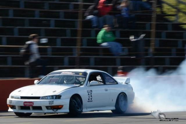

Originally Posted by pacotaco345 View Post
...Stock is 6?? Wow.. lol either my car is fucked or the alignment rack I took it to is fucked because I have stock tension rods and the machine read 8.4* on my car for both sides.
Yea, stock is really low compared to what most people run. I think some people just run higher caster so the wheels don't rub.
Originally Posted by koukistylejdm View Post
as you can see from that pic the trailing wheel isnt really important...
i did the whole 3rd gear bank with the wheel like that and never noticed until i stopped drifting (broken coilover)
LOL. I know what the leading tire and trailer tire do. I was stating that someone said the "leading tire" was the one following.

At my second event, really dont have a clue of what im doing lol.
