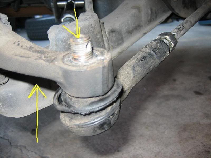

hey guys rite now im trying to take off my tie rod ends. after i have taken off the nut, do i juss hammer down the bolt to get it off? i have been trying very hard to get this tie rod end off and if i dont finish in time, i cant go to class.
any help is appreciated.

take a metal hammer (no pussy rubber shit) and smack the knuckle where the tie rod is attached
do that a few times and then give the tie rod a good light tap on the top and it should pop out
good luck, because sometimes it just doesn't come out at all.
i had to pull the whole knuckle off the car and take it to a shop.
acetylene torch, puller and a huge hammer and 30 minutes later, the master mech finally got it to pop out. it was actually on fire when it came out.

so i juss hammer that part up and then hammer the bolt down?
i'm currently doing that but i have no luck. doesnt even seem to budge.

no. you hammer the knuckle - the thing that the tie rod is stuck in
hammer that alot from the sides, all around
the vibrations shake the tie rod loose
then tap the tie rod from the top lightly and it will pop out

ok i been trying that too. i just sprayed some wd40 onto it and ill let it sit for a bit b4 i try to hammer some more. seems like it doesnt want to come out.

like i said, sometimes it just wont come out
dont be afraid to beat the living shit out of it
worst comes to worst, pull the knuckle off and get a ride to a garage. give the shop mech 20 bucks to do it.
acetylene torch ftw
So long as you don't need that balljoint, just hammer it with some backbone, it'll come down outta there. If you need the ball joint, screw the nut back on top and go for it.

take the nut that was holding the tie rod on, and thread it back on a bit (like 3 turns), then wail on the nut. That way you wont fuck up the threads.....been there.....FUCKIN HEADACHE!

if tapping/beating the shit out of it doesnt work
go to autozone and rent a tie rod seperator.. it slides around the ball joint.

yes i got it off. thanks a lot guys. but it seems like it didnt fix the problem i was having.....i guess 240s can never really be "fixed"
