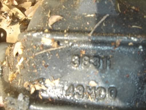

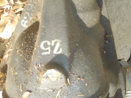

here are my pictures. so is it turbo or non-turbo
revd34 is offline   Reply With Quote

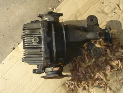

BTW your picture is not of a Z32 TT diff.
Here is one that we pulled off of a '90 TT:

Yeah, that is a TT diff, sell it on the z32 forums, and pick up a r200 style LSD.

nope that looks like a NA diff. It appears to have stock NA style input shaft.. If the OP could get us a better snout shot it would easier to tell. Like what the hell is with the leaves lol

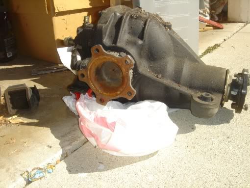

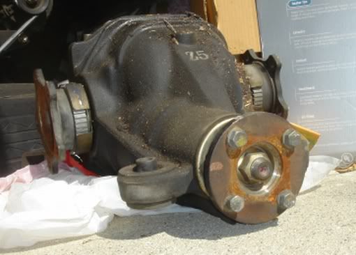

if you look at the diff, yours looks like a 5 bolt axles (from what I can tell)
TT uses 6bolts.
Im guessing you got R200V
Go get some axles, and drop it in.

here are some better angles. no leaves just a trash bag this time. so i just need to put the diff cover off my car onto this diff right and it should bolt up?

ahhh, i just looked at the output shafts from the top down and thought they were 6x1. The NA Z diffs i have seen have been 3x2 (like the 240sx). 5x1 is cool b/c it works n/p with the J30/180sx Axles.
But, the ABS sensor is not on the input shaft(j30), its on the output shafts (Z32). So does this mean the spacing on standard 5 bolt axles will be wrong?
dave??
