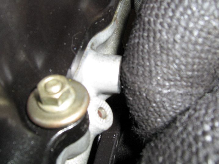

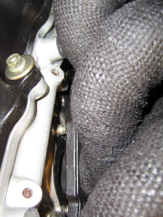

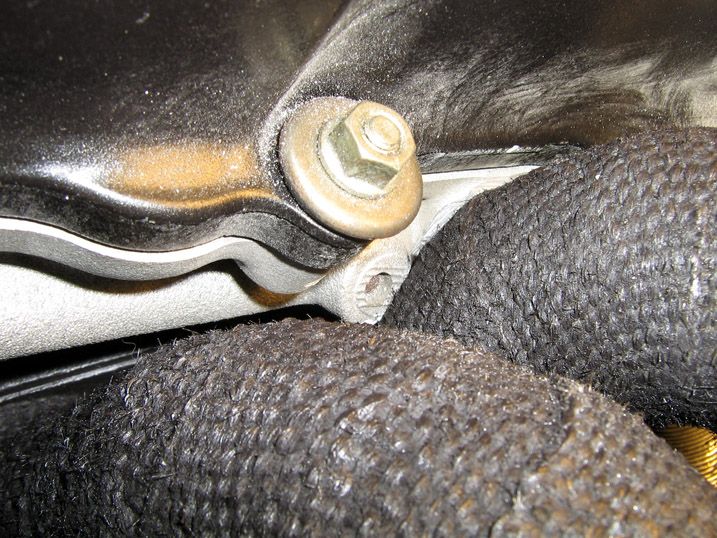

I go to test fit my manifold to the head. The #4 loop hits a bolt hole standoff in the head. I have about 10mm before the flange will be flush.
Could I grind down this standoff? Not using it for anything. Didn't bolt to anything and I think I can shave 10mm off it without hitting the head.

yeah you could, but what kind of manifold is that. kinda wierd that it would hit if the company did R&D on the manifold

shvae it down
should be fine
if not then weld it shut

It's an S14 SR. I say shave it down.

shave it.
haha ive said that before
seriously that looks like the mounting location for the stock heat shield.

Shave it. A lot of the equal length manifolds require it. I've got an SR here right now I just grinded a huge chunk out of in the same place.

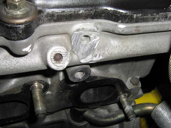

Shave it. Cut off the part that extends out on the head. I shaved mine.

Shaved her down:

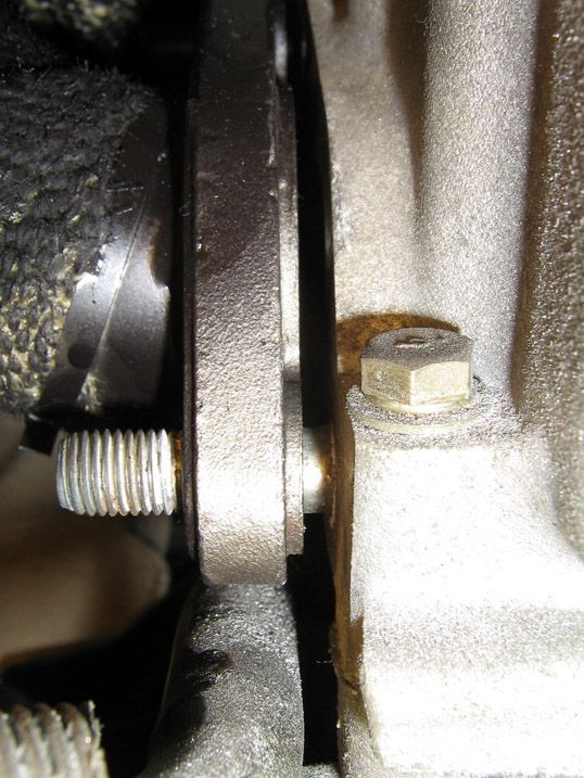

and it still hit the head:
Gap is still to big IMHO:
I'm sure I can wrench the manifold down and get it to seal. Yet, it will be pressing against the head which will put stress on it. Making it crack rather quickly.
Also, there is a tablespoon of oil in the compressor and turbine housings of my turbo. Leading me to believe that the seals are gone...
