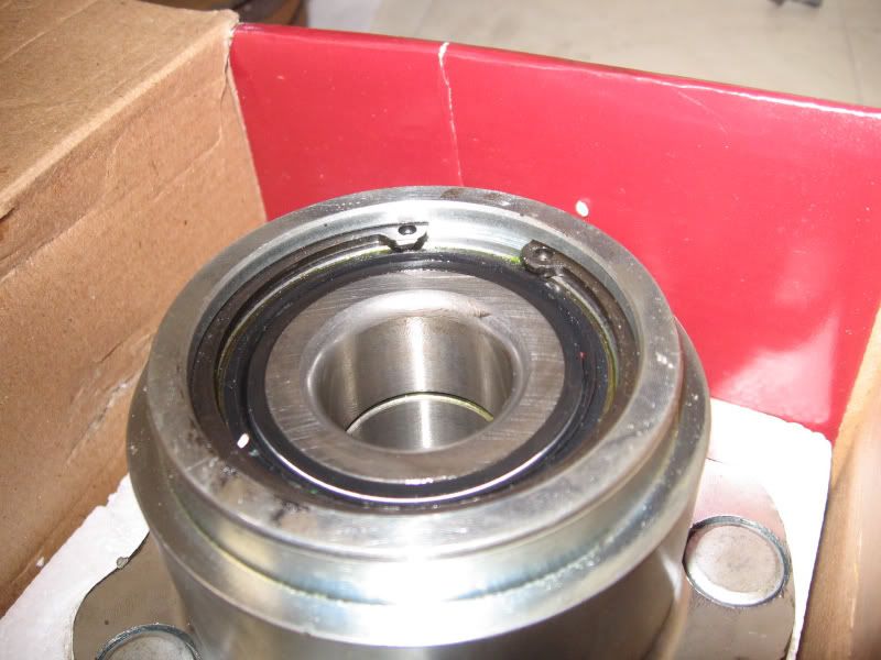

I took the 4 lug hub off, put the Ichiba right on and when I tighten the axle nut, the new hub does not spin. Am I doing something wrong?

Here is a pic. Only things I can think of is 1) Do I have to remove the snap ring? or 2) these are S14 hubs...

Why the hell is that snap ring there? OEM doesn't have it and it appears that if I remove it, the hub would seat all the way.

u should have a snap ring. tho ive never dealt with ichiba hubs, i remember back in the day there was a problem with peak performance hubs where the wrong snap rings were used. this might be the problem. of course, why would you be the only person with this problem? go figure =T

LEAVE THAT FUCKING SNAP RING IN, it holds the retainer for the bearing.

Well, I just read on Northwest Nissans that you have to replace the Ichiba retainer (left) with the OEM one off of the 4 lug hubs (right)
Gonna give it a try tomorrow and I'll update. Thanks for the help everyone!
From the looks of that pics its damn amazing that ichiba would sell them like that
Im willing to put good money that changing the snap ring will solve your problem, its ridiculous how much the tabs stick up on the ichiba one.

i am also havin the same problem as u. the washer does not seat fully like stock. it sits out a bit further. wen tightenin it down, the whole hub will not move. any ideas any1?

i just swapped the rings over and it seems it does work. the hub spins freely now, even wen the nut is tightened down

Swapping the retainers fixed it. Works perfect now...

WTF? I didn't change the snap rings on my ichiba hubs and they bolted on fine.

^^ did ur rings looked like the ones posted above?
