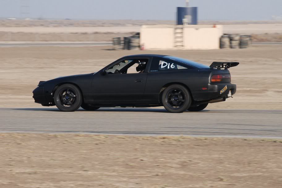

Here is how the car sits the front coils adjusted all the way down, the rears adjusted down half way.

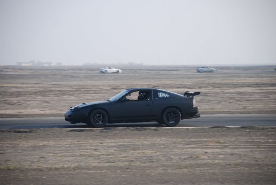

Under hard decel

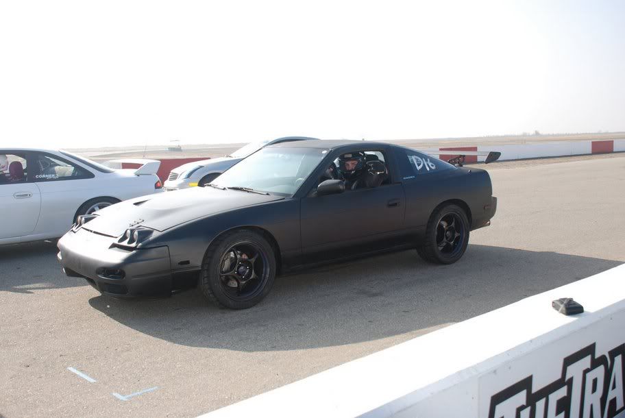

Slalom Acceration

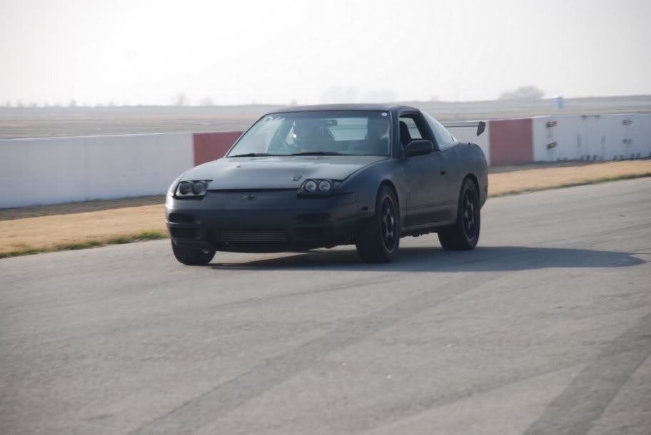

Acclerating from Pre-Grid
The car did not seem as rigid on outside roll over, or general body roll on hard decreasing apex turns.
