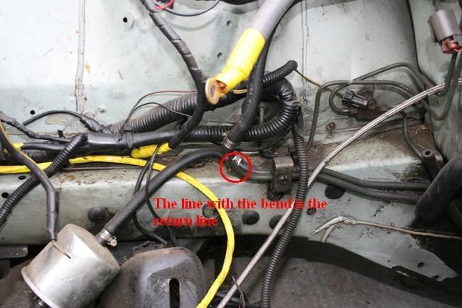

BOTH of the lines going to the fuel pump are DRY
When the pump is NOT connected to the fuel lines, the pump doesn't even send fuel at all.
Is there a pressure system that helps the pump send fuel? Is it possible I got the fuel lines reversed?
My car has been down so long I may have possibly reversed the lines in trying to figure out this fuel pump problem.

I believe you can get the lines reversed. The line from the fuel filter should go to the line within the intake... and then the line from the FPR should go to the other line that re-routes back to the tank. Did you try and disconnect the line at the engine and just turn the pump on briefly? Better to do that with a buddy into a container...

take off the lines at the sender, and click the key on to see if its getting fuel out of the sender first.
Did you need to ID which line is which? Let me go look at my car.
