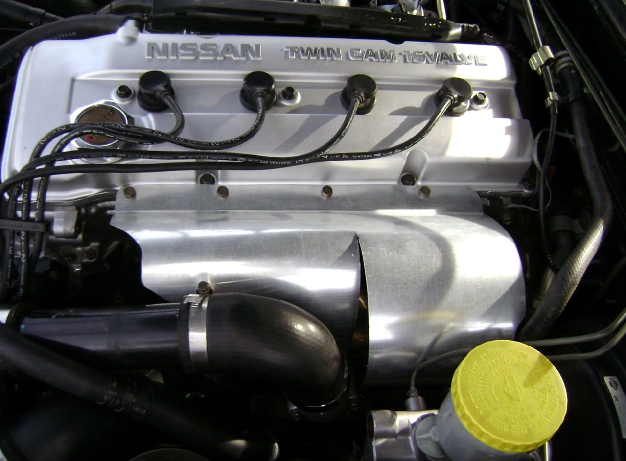

This is the same reason I choose to go KA-T (owned many SR20DET powered cars prior to going KA-T), because of cops and ref tickets, atleast its alot easier to swap back the KA to NA w/smog devices hooked back up.
Reliability is all in the tune so dont skimp there. Replace all gaskets, seals, hoses that you can while your at it.

Rad, stock looking KA-t!!!
+1
