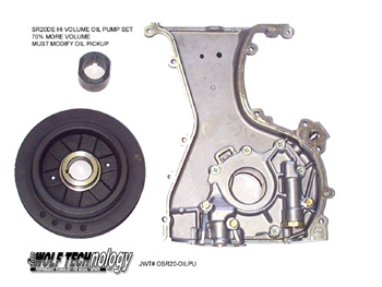

but see the pic. is the tomei oil pmp fit in the stock timing cover or must order with tomei cover

If you look at the FWD SR20DE front cover and the RWD SR20DET front cover side by side, you will notice that the two top most bolt holes are different (bolt to the head). On the FWD the bolt are accessible from the outside, as for the RWD these bolts are only accessible from inside of the head. Also, on the FWD front cover, one of the bolt hole is in a slightly different location in comparison to the RWD. There are other differences too, but those are the most noticable.
WilloW is offline   Reply With Quote

Actually, you could just look at the picture of the front cover that mohnissan posted, and pay close attention to the top most portion of the front cover where the cover bolts to the cylinder head. Note that the bolt holes are on the outside of the front cover, now look at your front cover and you will see that these same bolt holes are on the inside.
When I last had a look, I was comparing the GTIR front cover against the S13 Blacktop's. I figured that all the FWD front cover has the same configuration since the FWD guys are using these as upgrades.

I just happend to notice that the "JDM" SRDET Oil pump and the "USDM" SRDE Part #'s were the same but Im gonna look in to this though. I gonna try to get my hands on a Senta SR20DE pump and compare first hand.
If they're the same, I'll buy you a beer whenever you're in Dallas.
HaHa Sounds good to me ^_^b

Originally Posted by johngriff View Post
the GTI-R front assembly is diffent from all others in all respects, including the water pump.
If it is just the top holes, drill and retap. Done deal. I am interested in this thread, and some answers.
Are you thinking about swaping front cover to get more volume? If you are, then I'm probably thinking the same.
There's a guy from Australia that fitted a GTIR oilpump/front cover onto a RWD SR, his reason for doing it was because he wanted more oil volume. With some minor modification, he got it to bolt on to the RWD SR with only one of the top bolt hole.
For a while I was thinking about fitting the VE front cover onto my Blacktop using the same method the Australian guy used, but I never had the time to do it. Ontop of that the VE front cover is about $250, and I had just purchased a RWD front cover. Someone on SR20 Forum, actually took apart the GTIR, DE, and VE pump gear to compared them and the GTIR and the VE pump gears are thicker (more volume?).
