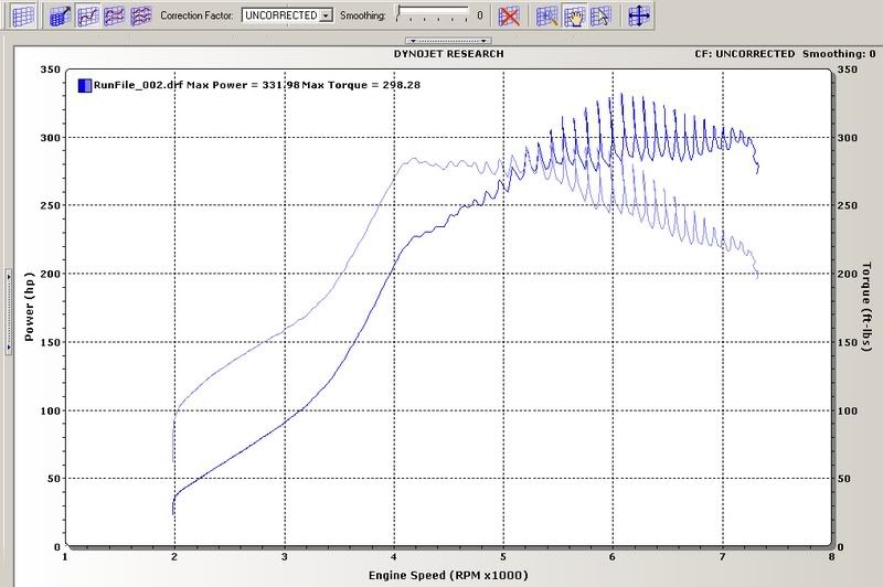

here is what you need to get the numbers you are shooting for:
this pull was on 18psi
completely stock redtop sr
gt2871r .64ar
sard 550cc
n62 maf
91 octane mixed with 5gals of 100 (full tank of gas)
CGTuning ECU (tuner here in Arizona)
fmic
3" straight pipe
AFR were around 11.5 under boost
now for the dyno charts!
the stuttering at the top is the clutch slipping. shitty clutch for the HP he has haha

nice to see that 550cc is enough for 330whp. I thought I needed bigger than 550cc to reach that power.
gt2871r .64ar
sard 550cc
n62 maf
fmic
3" straight pipe
That slipping clutch gave you a good 30whp, nice

Originally Posted by i need tires View Post
haha imagine if it wasnt slipping!
eh, you won't make much without cams even with that turbo, stock cams need to go around 300+, id be surprised if you actually hit 330 with that setup
umm the chart shows 331whp....
